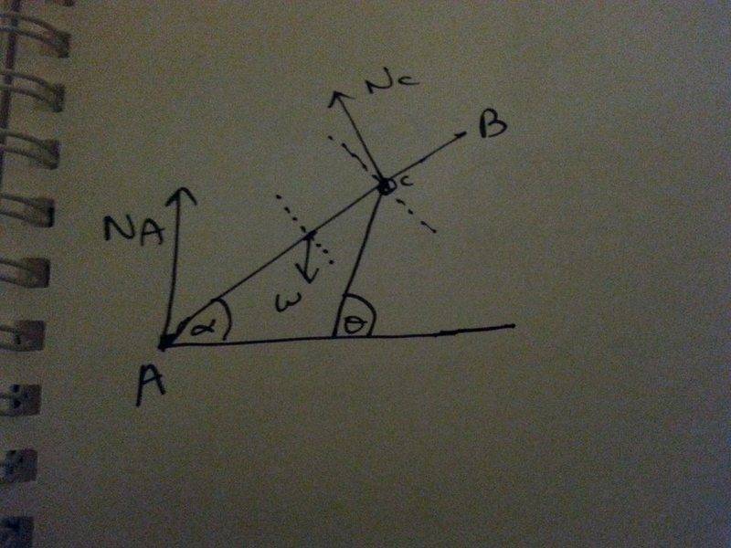

So this is the diagram I now have. I think we'll be using theta for the angle at C

It is a very poorly worded question but there are some clues to help us interpret it .
Which is inclined at the greater angle - the rod or the plane ?

Taniaz said:
I don't understand their orientation with respect to one another.
It is not entirely clear to me either... but you can make some headway by understanding that it is the plane that is at ##\theta## to the horizontal, and the rod that is at angle ##\alpha## to the horizontal.
The rod is supporting the peg?
The problem statement says that the rod is resting on the peg and the plane - maybe these are the rod's support: that is part of what your calculations will find out. But consider, if there were no plane, where would point C have to be?
So it'll be two angles a certain distance apart but in the same direction?
Maybe both angles are measured anticlockwise from the horizontal? That would be conventional - but the problem statement does not say. An alternative would be that ##\theta## is clockwise from the horizontal while ##\alpha## is anticlockwise. Part of the problem will be that you have to figure out which is intended.

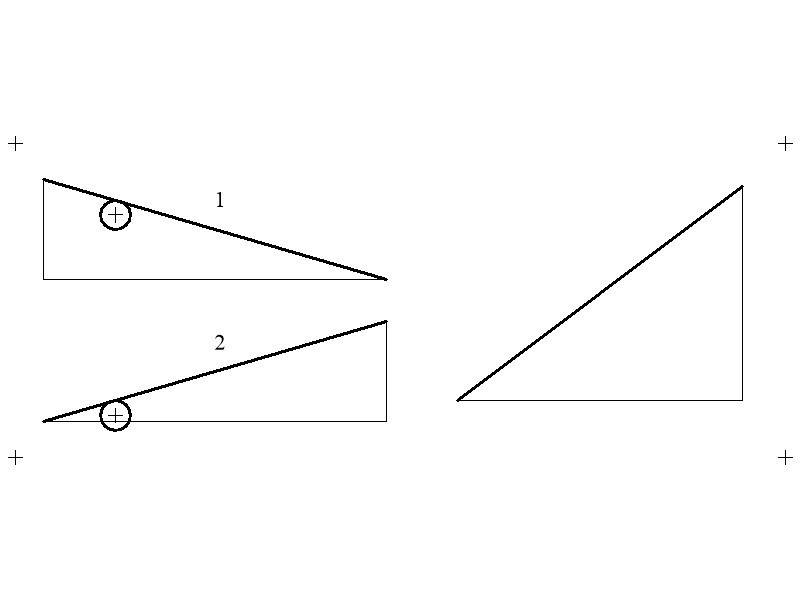

1 and 2 both seem to be valid interpretations of the question geometry but realistically 1 is the only one which can allow stability ?

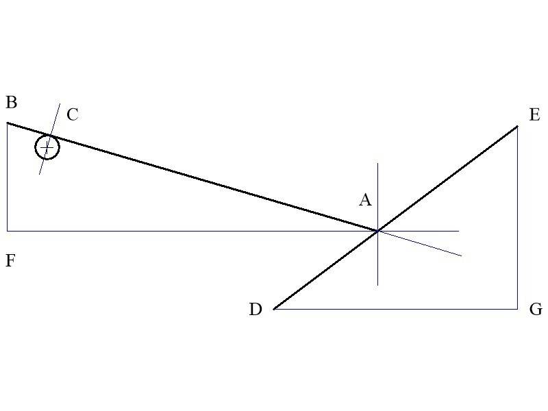

Nidum, where is the rod in your diagram? What do the plus signs stand for?
Simon could you please take a look at my diagram? Do we resolve any forces on the rod? We don't know anything about it other than the fact that it's supporting the peg.

The +'s are just frame delimiters from the CAD .
I'm sorry but I'm still not sure what's going on. All I'm getting are these equations?
Nc (x) = w cos (alpha) (1.5 m) and Nc sin(alpha) + Na = w where Nc, Na and x are unknown.
Really don't know where we're going to use theta - the angle between the rod and the horizontal.
Where is the rod in your drawings?? And where are the angles? That is what I don't get!
Bar is represented by line AB .
Plane is represented by line DE .
Bar is at angle tan-1 BF/AF relative to horizontal . Given as tan-1 7/24
Plane is at angle tan-1 EG/DG relative to horizontal . Given as tan-1 3/4

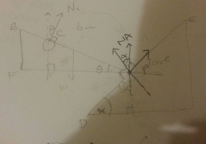

Ohh right ofcourse, because the plane is inclined so the normal acts perpendicular to it. So the vertical component of Na is going to be Na cos (alpha)?
So the equations are:
1) w = Na (cos alpha) + Nc (cos theta) -----> 40 = (4/5) Na + (24/25) Nc from Σƒ y = 0

2) Nc (x) = w cos (theta) (1.5) ------> Nc(x) = 48 where x is the distance AC from Γa=0
But it still can't be solved.
Am I missing something with these equations?
Draw a free body diagram of the bar and let us see it .
This is the diagram that I have with the components. Anything missing?

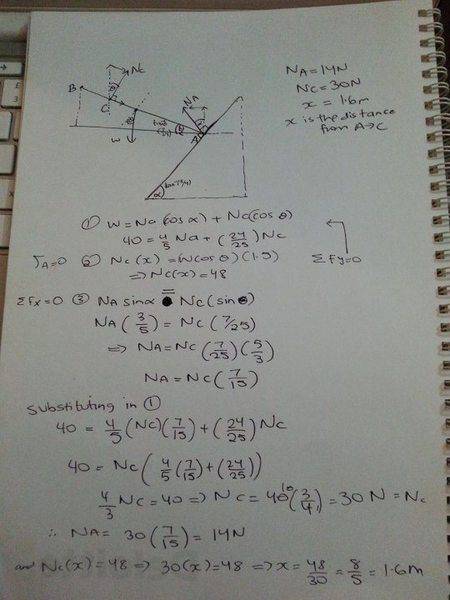

So am I missing something?
Forces in X direction
Forces in Y direction
Moments .
