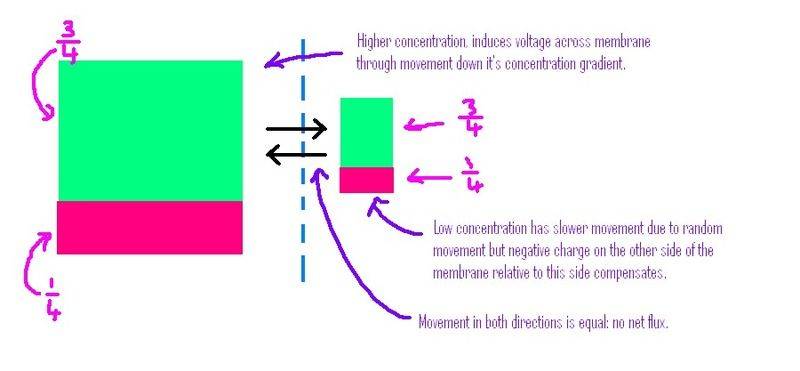

I drew some pretty pictures to illustrate my point. The blocks represent 'concentrations of ions', the larger the block, the higher the concentrations:
This is for a single ion. The concentration might be greater on the left, but as the ions move to the right, a negative charge accumulates in the cell, which increases cation movement to the left. Equilibirum is reached when the random movement to the left (which is lower due to a lower concentration) coupled with the increased movement to the left due to being attracted to the negative charge is equal to the random movement to the right. By my understanding, this is a stable equilibirum: it goes unchanged.
Here, there are two cations. The set-up is essentially the same. The system is in equilibirum for the reasons given above.
The system is in a stable state: the rate of cation movement is the same both ways.
In the above system, for any given cation moving across the membrane, the probability of it being the pink cation is equal in both directions, since it constitutes the same proportion of the total number of cations on both sides (remember, flux is equal both ways). The same is true for the green cations.
Even if they have different permeabilities, the probability of the pink cation being the cation moving in a given direction at any time is equal for both sides: it has the same permeabilites both sides of the membrane (again, the same applies to the green cation).
So the fluc in bboth directions is equal, and the probability of a specific cation crossing the membrane is equal both sides, this means that, for every pink cation that crosses to the left, one will cross to the right. As such, this seems to me to be a stable equilibirum, not just a steady state, since it doesn;t change over time. Additionally, it has a non-zero voltage.
Hopefully a visual illustration is better.
What's incorrect about the above reasoning? If it's true, then an equilibirum is possible without zero voltage across the cell.

Are you proposing that there is no concentration gradient for either ion, yet there is an electric potential difference?
Ooops, I see. You are proposing a concentration gradient. However, in your initial setup potassium was high in the cell and low outside, and sodium high outside and low inside. In your new diagram, it looks like both sodium and potassium are high on the same side of the membrane?
Thanks atyy.
Yes, sorry; through all my time spent pondering this I have played with different ideas and forget sometimes that I have not communicated this!
I have indeed moved both concentrations to be higher on one side. I was interested in knowing if both scenarios above provide a stable equilibrium.
If the concentrations of the two ions could arrange themselves into this concentration is something I am having difficulty with, and I was wondering whether the objection to their being an equilibrium with a voltage across the membrane was precisely because the above scenario could not be established, but the books I have found make no mention of any of this.
As mentioned, I am interested in knowing if both of the above are stable equilibria. The next step is then to determine if something analogous is possible under artificial, but reasonably approximate, cellular conditions.

Yes, looks correct to me. Basically it seems we are asking whether the zero net flux potential for two ions is the same as the zero net flux potential for each ion separately. This seems true under the assumption of the GHK equation and for the case where the ratio of concentrations on each side of the membrane is the same for each ion. However, I've never worked out this particular answer before, so would especially love commentary and corrections.
Under GHK assumptions such as a linear electric potential across the membrane, the current for one ion has the form
I=PV(Coe-V-Ci)/(e-V-1), where P is the permeability.
For I=0, we need (Coe-V-Ci)=0, ie. V=ln(Co/Ci), which depends only on the ratio of external to internal concentrations.
For two ions of the same valence, because the GHK assumptions include independence, I=I1+I2, where I1 and I2 have the same form as the one ion current. If we need I=0, as well as I1=0 and I2=0, this can be achieved if the ratio of external to internal concentrations of each of the two ions is the same, even though V is not zero.
In more general conditions I=0 is achieved by I1 and I2 being opposite in sign with equal non-zero magnitude, so the external and internal concentrations will eventually change considerably, unless they are replenished.
