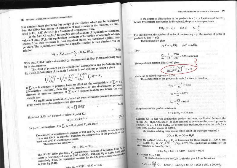

2.I am not able to figure out what is the number of moles of the products [itex]n_P[/itex] and the number of moles of the reactants [itex]n_R[/itex].The book's solution gives [itex]n_R[/itex]=3/2 and [itex]n_P=1+\alpha/2[/itex].
The author solves with the initial species as [itex]CO_2[/itex] and obtains the compositions [itex]CO_2=(1-\alpha)[/itex];[itex]CO=\alpha[/itex];[itex]O_2=\alpha/2[/itex], which is confusing given that the question states the reaction starts with CO and O2 in a closed vessel.

Borek,please find attached the problem I'm struggling with. I've highlighted the step which I do not understand also.
The K_p values were arrived from the temperatures empirically. But,what is the expression to the left in page 89?
  • Two facing textbook pages on internal combustion engine fundamentals and thermochemistry of fuel-air mixtures, with equations for equilibrium constants and an ideal gas calculation; a red circle marks the equilibrium relation giving 27.5 on page 89.

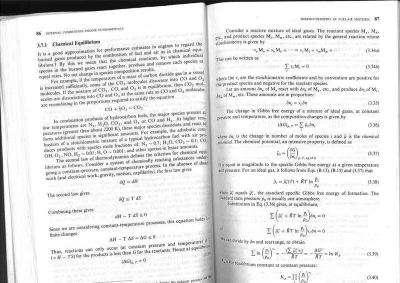

Oswald Dilution Law, very helpful insight.Since, concentration=n/V , this is not how it is expressed in the red highlighted area(attachment previous post). I first thought this was a relation between K_p and K_c,but the units didn't agree. It doesn't agree even in the Oswald dilution law.
$$\frac{1-\alpha }{\alpha (\alpha /2)^{0.5}}{\frac{n_p}{p_p}^{0.5}}=K_p $$
I also Attached 3.40 eq.
  • Textbook page 87 on thermochemistry of fuel-air mixtures, showing the chemical equilibrium equations: reaction stoichiometry, Gibbs free energy change, chemical potential, and the equilibrium constant Kp = product of (pi/p0)^vi (3.40).
