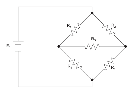

A fine choice for an image. Now, note the layout. Imagine that the middle resistor R3 is removed for now (This resistor is called the "bridge" component, since it forms a bridge between the middles of the two parallel branches). On the left there are two resistors R1 and R4 that form a potential divider across the 24 V supply. On the right side is a similar pair, R2 and R5, which form another potential divider for the 24 V. So without R3 there you could easily determine the potentials at those two middle nodes with a voltage divider formula used on each pair.
Now, the potential that a potential divider produces at its center node depends upon ratios. If the components of two different potential dividers have the same ratio, both potential dividers will produce the same voltage division. In the above circuit, if R1/R4 = R2/R5 then the middle nodes of the bridge would be balanced (Ignore the actual values that were included on the picture, we're just looking at theory right now). This is the sort of symmetry that you look for in bridge circuits that can be helpful: Equal component ratios on either side of the bridge let you know that the unloaded (no R3) potential dividers would produce the same potential.
Now, if that were the case (equal potentials) then laying R3 back into the circuit would do nothing! It would have the same potential at both of its connections, so no current could flow through it. The circuit would be undisturbed in any way by reconnecting R3. So R3 might as well not be in the circuit (when the bridge is balanced).
Once you have digested that, see if you can follow jbriggs444's advice and match the components from your circuit to their equivalent locations on this new bridge diagram. For bonus points, determine if your bridge is balanced!

php?image=http%3A%2F%2Fwww.electronicsteacher.com%2Fdirect-current%2Fdc-network-analysis%2F00486.png
This is a passive linear circuit. It contains resistors as passive elements and battery as active element. Linear circuit has its output "proportional" to the input. For instance, resistor current is proportional to the voltage across it,but the V-I curve for a diode is not linear.
##\frac{V_1}{V_2}##=##\frac{R_1}{R_2}##
Is this formula correct?
Of course in case of resistance?
  • #36
gneill said:
R1/R4 = R2/R5
Why R1/R4 = R2/R5 and not R1/R2=R4/R5 ?
  • #37
Isn't it one and the same expression?

So what in this case?Can I apply either of the two equations?
  • #42
Yes but the equations are true only for a "balanced" bridge. For this circuit, you'll need KCL and KVL.

  • #44
gracy said:
No,I don't think we can apply either of them.
That's because the "ratios" aren't equal. If they were equal, Va would be equal to Vb i.e. Vab would be 0.
  • #45
cnh1995 said:
Vab would be 0.
And bridge would be balanced?
  • #46
Yes. That's why the middle resistor is equivalent to an open switch in the balanced condition. It doesn't matter if it is there or not.

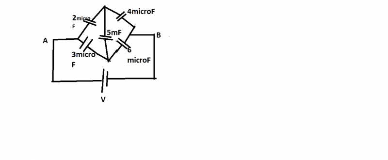

  • #51
How to do that?How I will know this capacitor should come in between i.e which capacitor would form C3 ?Which of them would be C1,C2,C4?And moreover there is no voltage in my actual problem .
  • #52
You'll need some practice for "spotting" the bridge in the circuit. Same goes for star-delta conversions in more complex circuits.
Always assume a voltage source between the points between which the equivalent resistance or capacitance is asked. Equivalent resistance or capacitance between two points is actually the equivalent resistance or capacitance "seen" by a voltage source connected between those points.
  • #53
In the given circuit,after assuming the voltage source,if you trace the path of current through the capacitor branches and observe the 'splitting' and 'reunion' of the currents carefully, you'll realize its a bridge.
  • #54
cnh1995 said:
After assuming the voltage source,if you trace the path of current through the capacitor branches and observe the 'splitting' and 'reunion' of the currents carefully, you'll realize its a bridge.
Applying these I drew a diagram (Sorry it is not neat)
As my bridge is not horizontal it is vertical hence formula to check whether it is balanced or not would be
##\frac{C1}{C2}##=##\frac{C3}{C4}## and not C1/C4 = C2/C5
Putting values
##\frac{2}{4}##=##\frac{1}{2}##
##\frac{3}{6}##=##\frac{1}{2}##
Hence the bridge is balanced.
Right?
  • #55
You can label your components in any order you wish. If you are going to refer to them in formulas you should show their labels on your circuit diagram.
Putting values
Right?
Right!
Which means you can remove the "bridge" component without affecting the circuit. Then look to see if any parallel or series reduction opportunities have appeared as a result.
