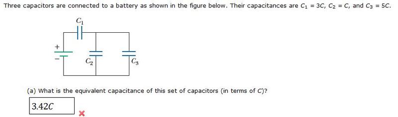

NotCarlSagan
1/Ceq= 1/C1 + 1/C2
1/C13eq= 1/3C1 + 1/5C3 = 8C/3 = 2.67C
1/C12eq= (3C x C)/(3C + C) = 0.75C
Ceqtotal = 2.67C + 0.75C = 3.42C
I think the series circuit is throwing me off?
Consider the combination of C2 and C3 as a single capacitor in series with C1.
NotCarlSagan said:
1/Ceq= 1/C1 + 1/C2
That's the equation for caps in series. What about the equation for caps in parallel?
