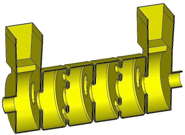

I have an RF structure:

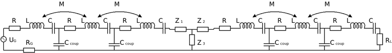

which I represent as an equivalent circuit:
and it works pretty well.
Now I want to add a waveguide between them. So I take an equivalent T-circuit of the waveguide:
$$Z_1 = Z_2 = Z_0 \tanh{\frac{l\gamma}{2}}\\
Z_3 = Z_0 \frac{1}{\sinh{l\gamma}}$$
In my case waveguide is lossless and operates above its cutoff frequency. So it should behave like an ideal phase shiftier when its length changes.

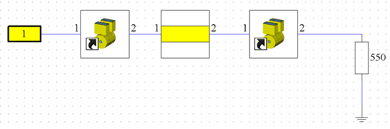

Now, to simulate the connection of two RF structures, connected by a waveguide, I take their equivalent circuits and connect them with the circuit equivalent of the waveguide:

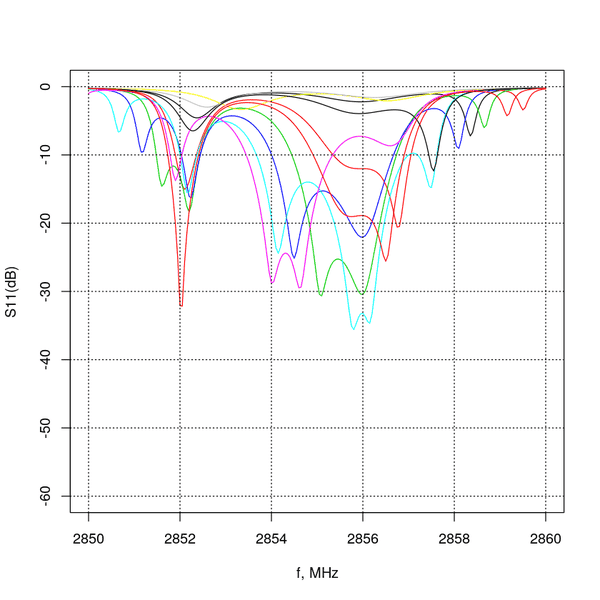

The calculation result is (for different l):
While the FEM calculation is:
In terms of incident and reflected waves, RF structures are tuned to not have a reflected wave in frequency 2856. When the length of the waveguide is changed, reflection should not be (much) higher than for the single structure. That is what FEM solution shows. Equivalent circuit solution gives a completely different result.

Not sure what are you talking about. I'm looking for huge errors. The first plot, with two lines on it, is an example of a good matching results. I'm comparing two last plots between them (each calculated for different length of waveguide).
