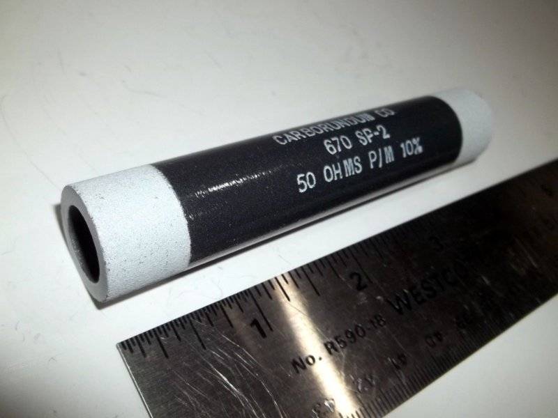

We need a high power dummy load in the 4kw range. for the amateur hf bands. The oil cooled "cantenna" type are at the most 1.5 kw. I have acquired 4 of the resistors used in these 1.5kw cantennas. my thought was to put two in parallel and two more in parallel then put those two parallel circuits in series to create a 50 ohm load. the resistors coming from a dummy load application are non inductive. I've seen home brew dummy loads built using parallel resistance to up the watt handling with good results.
My completed dummy load displays 52 ohms of resistance. when put on the hf bands, it is good at the lower ones but 4.5:1 in the 10 meter band, in the 28MHZ band. the construction is done on a piece of sched 80 pvc pipe with aluminum heat sinks under each mounting clip. the wire used is 12 gauge stranded copper thhn. crimped lugs were used and then all connections were additionally soldered. the wire lengths could be a bit shorter but are not excessively long.
Am I correct in thinking that with increased impedance I'm seeing at higher frequencies is inductance from something? I am anxious to see your thoughts.

The wire-wound resistors you have used are going to increasing inductance as the freq is increased. This is normal.
Most guys will use a high voltage capacitor in parallel with the resistor network to null out the inductance.

Hi Dave
thanks for getting back to me so quick. The resistors are not wire wound, but are ceramic. They are made for oil cooled dummy loads.
My thought was that maybe making my connections with copper strapping as short as possible, rather than 12 ga stranded wire would reduce my inductance. I like the idea of using a cap to null the inductance though. I might get by without having to do a total rebuild. your concerns on the so239 are heard and considered. The duty cycle in the present application will be about 10 seconds then about a minute before the next transmit.
you really sure of that ? ... .ceramic doesn't conduct
I would expect, and these looks like a coil on the ceramic tube
show me sharp up close and easy to read photos, specially of any info markings

@MotoMike -- do you have access to a low-cost hand-held LCR meter? Or maybe one of your other local HAMs has one? If so, you can measure the inductance of the power resistor, and that will tell you pretty quickly it if uses wire-wound construction.
Thanks for the help guys. I'm quite sure the resistors are not wire wound. I know that ceramic does not conduct, I think from looking at the construction that it is probably a doped mixture that has been fired. some quantity of carbon mixed with the slip to make 50 ohms. there is no evidence of wire on the resistor. I'll take a better shot for you when I get back in the shop on Wednesday.
they are of a similar construction to the one I've attached an image of here
.https://www.kanthal.com/globalassets/kanthal-global/downloads/resistors-and-capacitors/1-aa-series-800-1000-tubular-resistors.pdf

Ideally, you would Bridge the resistors and find their inductance at low frequency. If you don't have that facility, you could get a value of its low frequency L by resonating it with a selection of C's from the 'drawer' ( a Marconi Q meter used to do this job pretty well). Then do a frequency sweep of the resistor and try to tune it with a variable / or various capacitors - starting perhaps with a C value that assumes no parasitic C and then reducing the value. But basically you should be working 'on the bench' first so that you will have an idea of what's actually needed. If you have the luxury of being able to 'look inside the box' then make use of it. If it transpires that the resistors are actually wire wound then you could easily find a ball park figure for the inductance with one of the many on line calculators.
It is much easier to find a solution tho this sort of problem if you can isolate the factors one by one. (Sorry if this is telling you how to suck eggs but it could save you a lot of time if you do it that way.) You may be handicapped by lack of test equipment - then you just have to be more inventive.

If the resistor has inductance, then if you resonate it with a shunt capacitor, then the resistance value will increase.
I notice that the connecting leads are very long, by the way, which will add inductance. Why do you make everything so spread out?

If you have inductance in the resistor itself, and you add shunt capacitance, then it forms a L-match and you will measure zero reactance but much higher resistance. On the other hand, if it is the connecting wires adding inductance, if you now place C across the actual resistor, such that reactance becomes zero, then you will measure an input impedance which is a lower value of R with zero reactance.
The VSWR of 4.5 is very high and I think it is a result of your long, meandering connecting leads. I am not too concerned about the connector you are using because VSWR of connectors is not an issue up until about 1 GHz and the connector has a thick pin for handling large current.

I would first eliminate those flying leads by replacing them with a coaxial cable to reach deeper into the cooler transformer oil. Then drive two parallel chains of two series resistors, without the long leads.
Mount the cylindrical resistors in perforated metal coaxial tubes, with inner diameter calculated to give 100 ohm line impedance in oil. Then you connect the two tubes in parallel to the 50 ohm line. Make sure the resistor current can return all the way up the inside of the perforated tube to reach the coaxial braid or socket ground. That balances and screens all RF currents.
For best HF performance, the resistors at the ground end of the tubes can be in a tapered perforated tube to further reduce ground terminal inductance. Solder the ground end of the resistor to the narrow end of the perforated tube.

the help here is much appreciated. the analyzer I spoke of did read the circuit and confirmed that there was about 305nh inductance seen at the input. I used a variable cap in parallel with the resistive network and found I could null out the inductance at about 100pf I the mid 28mhz range. it allows the load to exhibit less than 2:1 swr 160 through 6. we have some door knob transmitting caps in the parts drawer that I am hoping oneis near the range I need. I will let you all know how it works out. the advice here was very useful.
That 305nh inductance is equivalent of a 100 mm diameter single turn loop. That is fully explained by the flying leads you have. Replace those leads with current return straps that run parallel with the resistors like a transmission line, it will neutralise that reactance over a wide band. If you add a capacitor you will only make the load frequency dependent which will cause all sorts of problems.
