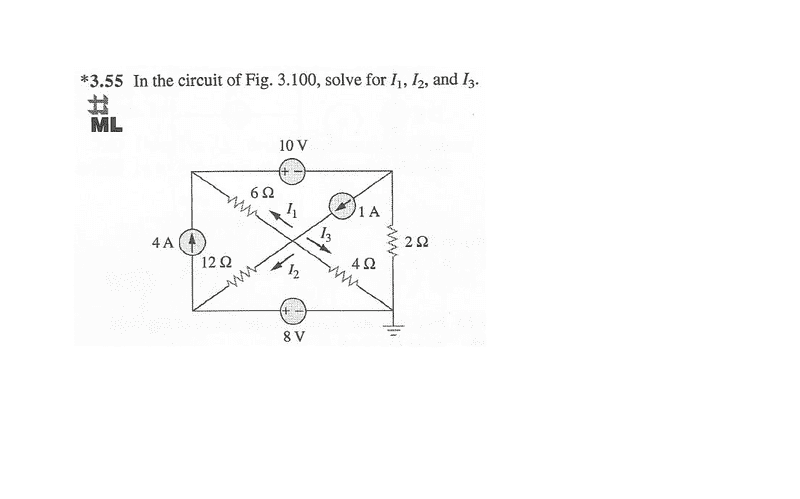

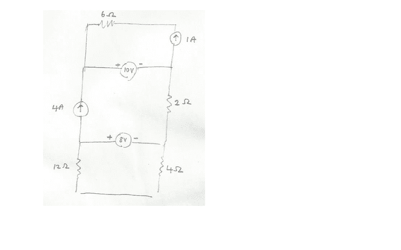

Just wondering if its ok to re-draw this
http://postimg.org/image/a074v6cor/
as this
http://postimg.org/image/uvtf6f8vv/

But, out of curiosity: is the central point in the first picture a connection or is I1 = -I3 ?
Whether the central point is connected or not, the redrawing is not correct. One discrepancy (and there are others): in the original drawing, the 4 Ω and the 6 Ω share a node. In the redrawing, they do not.

No
Circuit schematic with a 10 V source on top, 8 V source on bottom, 4 A and 1 A current sources, resistors 6 Ω, 12 Ω, 4 Ω and 2 Ω, and currents I1, I2, I3 labelled, with problem text *3.55 above.
Is not the same as
Hand-drawn circuit schematic with a 6 Ω resistor on top, a 1 A current source at top right, a 10 V source, a 4 A current source on the left, an 8 V source, and 2 Ω, 12 Ω and 4 Ω resistors.
Your circuit would force I3 = -I2
and I1 = 1 Amp
  • Circuit schematic of a resistor network with a 10 V source on top, 8 V source on bottom, 4 A and 1 A current sources on the sides, resistors 6 Ω, 12 Ω, 4 Ω and 2 Ω, and currents I1, I2 and I3 marked on the diagonals.

  • Hand-drawn circuit schematic with a 6 Ω resistor across the top, a 1 A current source at the upper right, a 10 V source, a 4 A current source on the left, an 8 V source, and 2 Ω, 12 Ω and 4 Ω resistors.

It would be correct if you add a wire from the point between the 4 and 12 ohm resistors at the bottom to the point between the 6 ohm resistor and the 1 amp current source at the top. You separated the 4 wires coming together in the midpoint into 2 pairs.
