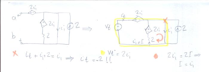

Hand-drawn circuit with terminals a and b, a dependent voltage source 2i1 and a 2 ohm resistor, beside a redrawn version with a highlighted loop containing Vt, 2i1, 2 and a current source of 2; below are handwritten equations such as it + i1 + 2 = i1, Vt = 2i1 and 2i1 = 2I.
as you see I can't obtain Vt=(alpha)it+(Beta) that alpha is thevenin resistance and beta is Thevenin voltage.if there is no problem could you tell me
1-when we find vt or it value instead of their linear equation what does it man?
2-In above circuit can we find i1 value?
3-In above circuit what is Thevenin's Equivalent circuit?
Thanks

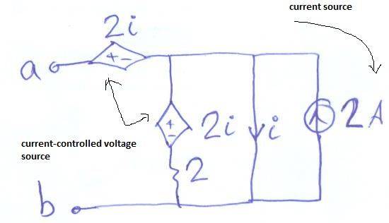

Could you neatly sketch the circuit whose Thèvenin equivalent you are required to find? Also label it so there is a clear difference between 2 and Z. What is the symbol of a circle with a central arrow?
Hello
here is neatly sketch and I define the name of each source and the value is "2" (in Volt , Ohm,Amper)
Hand-drawn circuit schematic with terminals a and b: a current-controlled voltage source labelled 2i in series with a dependent voltage source labelled 2i and a resistor labelled 2, in parallel with a current labelled i and an independent 2 A current source.
What appears to be a short-circuit across the current source really is a short-circuit across the current source?
The values shown make no sense. There can be no "solution" here.
The arrangement with the addition of vt is feasible and has a solution, as you found.
It's not clear what this is about, though. Are there more details you can provide about the question?

It is just a circuit course problem and I want to know better the thevenin rule in this question
baby_1 said:
... I want to know better the thevenin rule in this question
And do you think that it will help that you have ignored NascentOxygen's questions?
In other words, you have to help us help you, otherwise we cannot.
