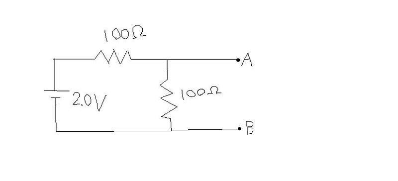

Find Thevenin equivalent circuit as seen across terminals A and B for each circuit.
[tex]V=IR[/tex]
Those resistors are in parallel because not all of the current going through the top one is going to go through the next one, right?
So I add the resistors to make an equivalent resistance, but I'm not sure what to do after that.
I need to find the open-circuit voltage, but I don't know how to do that mathematically.
And I need to find the short circuit current, which is [tex]I=\frac{V_T}{R_T}[/tex].
Is the [tex]V_T[/tex] just the voltage source? And is the [tex]R_T[/tex] just the equivalent resistance that I found?
Thanks.
[tex]V=IR[/tex]
Wrong argument.
What's the voltage across terminals A and B? That's your open-ckt voltage.
If you short those same terminals, what's the current? That's your short-ckt current.Is the [tex]V_T[/tex] just the voltage source? And is the [tex]R_T[/tex] just the equivalent resistance that I found?
No. The thevenin voltage is the open-ckt voltage and the thevenin series resistance is the open-ckt voltage divided by the short-ckt current.
Thanks.
See above.
What do you mean by wrong argument? That's not the reason they're in parallel? There's a different reason they're in parallel? Or are they not in parallel at all?
The open circuit voltage would be [tex]V_{Th}=\frac{(2)(100)}{100+100}=1[/tex] right?
And the short circuit current would just ignore the middle resistor and that would be [tex]I=\frac{2}{100}=0.04A[/tex] right?
Ok so [tex]R_{Th}=\frac{1}{0.04}=25[/tex]
So to answer the question posed, I would make a circuit replacing the [tex]V_{in}[/tex] with [tex]1V[/tex] and replace the two resistors with a 25 Ohm resistor?
Thanks for the response.
Right. But call it 1V.
Wrong. 2/100 does not equal 0.04. And, you're not "ignoring the middle resistor", you are shorting out the resistor across the output terminals.
Correct your mistake and you're on the right track.
There are two kinds of Thevenin equivalent circuits. One is a voltage source in series with a resistor. The other is a current source in parallel with the same resistor. If you do it right and derive both, you will see that both have the same open-circuit voltage and short-circuit current.
See above.
