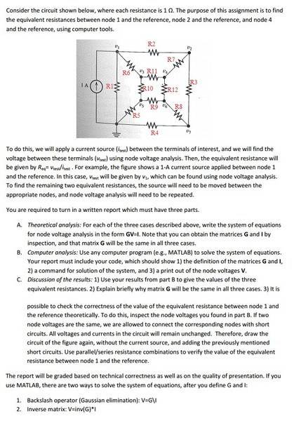

I think what the problem wants me to do is:
1) connect a 1A test current from the ground source to v1 (like shown in the picture), find v1 using node voltage analysis, then find the equivalent resistance by dividing the test voltage (v1) by the test current, which is 1A.
2) connect a 1A test current from the ground source to v2. Repeat steps, where now v2 is the test voltage, to get equivalent resistance.
3) same as above, except with v4.
When I set up my system of equations I get too many unknowns.
For example, trying KCL on case 1 (where 1A is connected to v1), I get this system of equations:
v1/R1 + (v1-v2)/R2 + (v1-v3)/R6 = itest
(v2-v1)/R2 + (v2-v4)/R7 + (v2-v7)/R3 = 0
(v4-v2)/R7 + (v4-v3)/R11 + (v4-v6)/R12 = 0
Plugging in 1 for i and for all R values still gives me 6 different voltages to solve for, and only 3 equations.
Using the same method for case 2 and 3 (where vtest is v2 and v4 respectively), I get nearly identical systems of equations, the only difference being which equation is set equal to i instead of 0.
There are seven essential nodes, plus the reference node. So you'll need to write seven separate node equations. That's a lot of equations to bash away at by hand :smile: which is why the problem suggests using a computer and the matrix method; The node equations can be written by inspection into matrix form.

You should have 7 equations in 7 unknowns, the unknowns being the node voltages. The G matrix will be a square 7 x 7, the V and I vectors 1 x 7.

I should have mentioned... also note that not all the entries of the G matrix will be 1. The entries on the diagonal will be the sum of the conductances connected to the given node, while the off-diagonal entries will have negative values (or zeros).

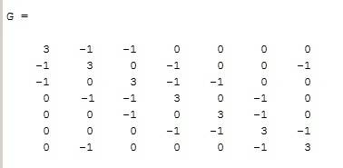

I tried to check the values by part C) 3) of this problem. I ended up getting 0.111Ω for the total equivalent resistance, and 0.333Ω for the equivalent resistance at node 1. (Not sure which one I am supposed to be looking for)
This is what I got for my G matrix:
EDIT: Just realized I made a mistake in row 4. Here is the new G matrix:
(The only difference is a -1 value on the 4th row, 2nd column)
These are my newly obtained values:
v1 = 0.5833V
v2 = v3 = 0.3750V
v4 = 0.3333V
v5 = v7 = 0.2083V
v6 = 0.2500V
