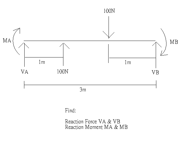

x850xtpe
Here are more unknows need to slove while I had only two equations which are sum of force on y-asix = 0 and sum of moment = 0. It is out of my learn. How can I solve these unknows?
Not sure what you mean by "sum of moment = 0," but for equilibrium problems, I know you need to sum the forces in the x and y directions, sum the torques in the x and y directions, and set them equal to zero as you said, since everything is in equilibrium. Solve for your unknowns.
The moment which is cause the body to rotate, like torque.
Althought I had built the 2 equations, sum of moments = 0, sum of forces acting on y-asix = 0, I still cannot slove these unknows. I had not set the equation sum of forces acting on x axis, it is because no forces action on x-asix in this case. It is particular problem...

Your beam is statically indeterminate, which means that you cannot obtain the reactions by simply applying the static equilibrium equations (note that you have four unknowns and only two static equilirbrium equations, eg. one moment equation and one force equation in the vertical direction).
You must use elastic equilibrium equations as well to solve.
