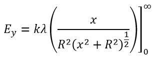

I can find the e-field at point P.
I get, easily enough, the correct integral solution (for the y-component, Ey - which is all I need to do):
which I can see, informally, evaluates to:
which is the correct answer.
My question: is it, technically, sufficient for me to simply explain: "well, when evaluated, the infinity in the numerator cancels with sqrt(infinity^2) in the denominator? Or can I offer a more rigorous explanation?
I tried L'Hôpital's Rule, but it doesn't seem to lead anywhere as far as showing anything definitive.
Thank you - any hints are appreciated!
Try factoring out ##x^2## from the squareroot in the denominator, you should know how the resulting ##R^2/x^2## behaves when ##x \to \infty##.
Hmmm (thanks!). Yes, R2/x2 disappears as x→∞, but that now leaves an un-cancelled x in the numerator that is going to infinity.
You're not factoring the denominator correctly.
(x2 + R2)1/2 = {x2(1 + R2/x2)}1/2
= x(1 + R2/x2)1/2
etc.
Ach, yes. Sorry - and thank you!
