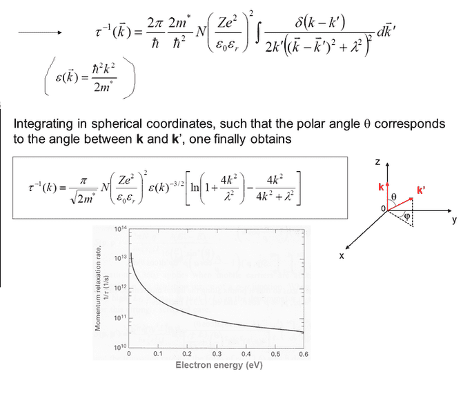

Hi,
I really don't have a clue to solve this.
Slide showing the scattering rate integral for electrons and its spherical-coordinate result, with a plot of momentum relaxation rate versus electron energy from 0 to 0.6 eV on a log scale, and a k, k' coordinate sketch.
