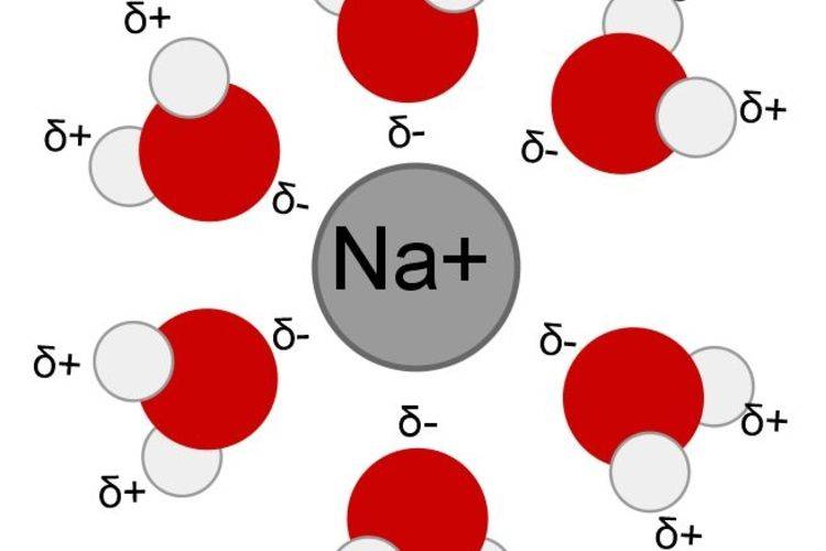

2) If you add salt to water, the dipoles on the water are attracted to the ions in the salt (this is also why it dissolves). These ionic(ish) bonds are stronger and more numerous than the hydrogen bonds in the water. This means it takes more energy to break them, so they are harder to boil.
