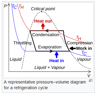

I’ve found Wikipedia helpful and have questions about the Wikipedia pressure-volume diagram. The temperature-entropy diagram is beyond me just now.

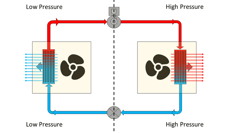

A compressor compresses the gaseous refrigerant, causing it to heat up. Then it goes to a condenser where it is cooled and condenses at constant pressure. Then it goes through the throttling valve where the pressure drops and it cools. The diagram on that wiki page should make it clear what the four devices are that are associated with the processes in the p-v diagram:

Thanks for including those diagrams.
I get the four stages of heat pump operation. I've been wrestling with the concept of how a heat pump compressor can compress a gas that it holds in a fixed volume.

They are indeed usually reciprocating compressors, like a bicycle pump. The volume of the compressor cylinder is obviously not fixed. The fact that the rest of the system has a fixed volume doesn't have any impact. Any closed system that moves a working fluid will have different pressures in different parts of the system. It should be intuitively obvious.

It works just like a bicycle pump; a piston with two check valves. But I don't know what you mean by "compression space". The gas moves into the cylinder from the evaporator through one check valve, then gets compressed and pushed out toward the condenser through the other:

A kind person inserted the pressure-volume diagram in my initial question, so I’ll add some questions about this diagram.
** Should I have made these questions separate threads?
*** How can heat pump evaporation occur at constant pressure?
The pressure-volume diagram (see above) shows evaporation happening at constant pressure while the volume increases.
I do not understand this because:
. The manufacturer fills the heat pump with refrigerant and seals it, leaving a fixed volume for the refrigerant.
. During evaporation, the refrigerant gas can expand into every space of the heat pump, and the volume of this space is constant.
. as the air heats the liquid refrigerant, more gas will boil off, and the pressure will build.
. It’s like cooking pasta with the lid on; the pressure builds until the lid rattles and steam escapes.
Perhaps this is how it works: You boil pasta for a long time, giving ample time for the pressure to build. Perhaps the vaporisation period for each heat pump cycle is brief, say five seconds, and over that short period, the pressure doesn’t build, so you can think of it as expansion at constant pressure.
** Can we assume that the expansion occurs at constant pressure because the heat pump expansion stage is always brief?
** What is a typical time period for one complete evaporation, compression, condensation and expansion cycle?
** Condensation at constant pressure
The diagram also shows the condensation occurring at constant pressure. Is this also because the condensation stage occurs over a brief time? Otherwise, I would expect pressure to fall with condensation in a fixed volume. Again, it could be like pasta; when you turn the heating off and leave the lid on the uneaten pasta, you must pull hard to oppose the vacuum and get the lid off.

Again, looking at the above pressure-volume diagram, the diagram shows:
. a blue, cold temperature (Tc)
. a red, hot temperature (Th)
. a pressure of condensation (Pc), and
. A pressure of evaporation. (Pe)
These variables will change during the propane heat pump operation, but are the following values plausible for an instant in time:
. Pressure of evaporation (Pe) = 2 atmospheres (atm)
. Blue, cold temperature (Tc) = at or below minus 25.6°C, say minus 27°C.
(The boiling point of propane at 2 atm = minus 25.6°C)
. Pressure of condensation (Pc) = 30 atm
. Red, hot temperature (Th) = 90°C
The boiling point of propane at 30 tm = 78.7°C
This would have the throttling /expansion stage:
. starting with a liquid at 90°C and pressure 30 atm, and
. ending with a liquid/gas at minus 27°C and 2 atm.
This seems wild, an enormous temperature jump!!
All these values are below the
. Critical Temperature 96°C, and
. Critical Pressure = 618 psi = 43 atmospheres
No, the refrigerant gas does not expand into every space, it only expands into the half of the cycle from the expansion valve to the pump. Since gas is simultaneously being expanded into the low pressure side by the throttling valve and pulled out by the compressor on the other side, the mass of refrigerant in that part of the cycle is fixed. The states at every location in the cycle are constant and the mass flow rates are constant (except inside the compressor cylinder). The states change only as the refrigerant moves from one location to another (such as through the evaporator). This is called a Steady State, continuous process(cycle).
No, that's not how cooking pasta works. The pressure in a boiling pot is constant, even with the lid on (you would not use a sealed pressure cooker to cook pasta).
Perhaps the vaporisation period for each heat pump cycle is brief, say five seconds...
No, there is no "vaporization period". Vaporization is always happening. Again: steady state, continuous process.

I might call that the high pressure side of the cycle. But yes, that sounds correct.
** As the piston sucks gas from the evaporator, does it reduces the gas pressure over the pool of refrigerant and so cool the refrigerant in the evaporator?
No, the pressure is constant on the low pressure side of the cycle, even when drawing the refrigerant in. While the compressor is doing that more refrigerant is flowing into the high pressure side of the cycle through the throttling valve, so the amount of refrigerant in the low pressure side is constant (or nearly so, as the volume of the compressor cylinder is much smaller than the volume of the rest of the system).
***** Alternative possibility B.
. This compressor takes in gas from the high-pressure space, then the piston compresses it and pushes it back into the same high-pressure space.
*** Is possibility A correct, and possibility B a misunderstanding?
Is there any website on this that you would recommend?
Possibility B is wrong. There's nothing hidden here: it's not in the picture I posted or the P-V diagram (refrigerant flowing backwards), so it's not part of the cycle. The wikipedia article explains this fully, and there's no need to go anywhere else.
I think you just need to get your arms around the idea of a continuous, steady state process and understand that we're not dealing with an intermittent batch process.
@GreenWombat you are getting hung up on words. You are 'overthinking it'. Don't worry about how the compressor works until you've wrapped your head around the refrigeration cycle.
Closed system, open system, it makes no difference. We compress a gas and it heats up. We then cool that gas by blowing ambient air over the container the gas is in. The compressed gas is then ideally at ambient temperature. Then we reduce the pressure of the gas by allowing it to expand into a larger chamber. The gas then cools below ambient absorbing heat from the environment. The gas is then drawn into the compressor to repeat the cycle. We could do this with air on an open system but the properties of using air as a refrigerant are not well suited. There are much better choices for refrigerants and in order to utilize them we need a closed system. In those cases there are parts of the cycle where the refrigerant is a liquid and other parts a gas.
I don't understand why you are hung up on how a compressor works. Are you having trouble with the claim of a fixed volume system and yet a piston type compressor changes the volume within the compressor?
Edit: What @russ_watters says is true. All these things are happening at once within the system. The refrigerant itself 'sees' these different parts of the cycle as it travels the loop.

The pressure-volume diagram suggests there are only a few temperatures and pressures to work out. In the cold, low-pressure space of the heat pump, there is:
. one low pressure (Pc), and
. one low temperature (Tc), which is the boiling point of propane at this pressure.
In the hot, high-pressure space, there is:
. one high-pressure (Ph)
. one high-temperature (Th), which is the boiling point of propane at this pressure, and
. a second superheated temperature (Ts) which is higher than Th.
****** Propane Boiling points
Here are propane boiling points from the internet calculator. Below I use the rounded values in brackets to keep it simpler.
Pressure Propane boiling point
1 Atm Minus 43°C
5.2 Atm (say 5 Atm) 14.9°C, (say 15°C)
16 Atm 74.47°C (say 74°C}
https://www.omnicalculator.com/chemistry/boiling-point#boiling-point-definition
***** The low-pressure space
To estimate the temperature in the heat pump's cold, low-pressure space, consider the temperature after evaporation and before compression. The pressure-volume diagram shows that the evaporated propane is a saturated gas. Since the gas is at its boiling point, the pressure will be the vapour pressure of the propane at this temperature.
This refrigerant has passed through a heat exchanger and is warmed by air at 17°C. I guess that the refrigerant will be cooler than the air, So I assume that Tc = 15°C.
** Is this reasonable, or should it be 17°C?
From my propane boiling point table, the propane vapour pressure at 15°C is 5 atm, meaning that Pc = 5 atm.
** Is this reasonable?
A controller keeps this refrigerant slightly superheated to prevent liquid from entering the compressor and damaging the heat pump. I will ignore this.
** Would it be easy to include this in my figures?
The propane after the expansion valve and before the evaporator will be at the same Tc = 15°C and Pc = 5 atm, still at boiling point but with a mixture of propane liquid and vapour.
****** The high-pressure space
To estimate the temperature in the heat pump's hot, high-pressure space, I consider the temperature after condensation and before expansion. Here, the pressure-volume diagram shows that the condensed propane is a saturated liquid. This liquid is at its boiling point, so the pressure will be the vapour pressure of the propane at this temperature.
This refrigerant needs to heat the hot water to 60°C, so I have assumed that the propane needs to get a good bit hotter than that, so Th = 74°C.
From my propane boiling point table, the propane vapour pressure at 74°C is 16 atm, meaning that Pc = 16 atm.
The pressure-volume diagram shows that, after compression, the propane is at the same pressure as after condensation, but it is now a superheated vapour. Its temperature will be higher than that of the saturated liquid after compression, Th = 74°C. Assume Ts = 80°C.
*******Is this real or an ideal
** Is this pressure-volume representation of a heat pump an ideal?
** Does a real propane heat pump come close to this?
Now I wonder how a real propane heat pump could behave like this ideal. (1) In vaporisation, the heat pump transfers exactly the latent heat of vaporisation into the propane, and (2) the compression does superheat the propane, so condensation transfers to the hot water its superheat and then exactly the latent heat of vaporisation.
** Any references to help here?
That's pretty much all fine. Only a couple of minor comments:
-Your approach temperatures(minimum difference between the working fluid and the source/sink) are a little close - but fine for a sample problem.
https://enggcyclopedia.com/2019/05/heat-exchanger-approach-temperature/
-There's less control on small systems than you seem to think. For most small systems there is zero active control other than start/stop. There might be fan on/off but even that is more of a safety. The hot side and cold side conditions will vary somewhat to achieve an equilibrium, as the source and sink temperatures change. To avoid liquid in the compressor there's usually some superheat. The cycle isn't and doesn't need to be precise otherwise.

What does the P-V diagram say?
I asked how the liquid propane gets from the bottom of the evaporator to the top where the fan is. You say the pump forces it. For the flow through the evaporator heat exchanger pipes, there must be a pressure drop and this will push the flow. So, there is a pressure drop across the evaporator! Now it seems to conflict with the pressure-volume diagram. I thought that the diagram showed the experience of one gram of propane as it moved around the heat pump, with the propane’s trip through the evaporator occurring at a constant pressure.
It's too small to be visible on the P-V diagram and can be ignored.
