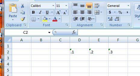

If I want to lookup row 3 column "amz" and the end result will be side by side, how do i do that Example: a=.4 m=.91 z=.22
input; amz
output: .4.91.22
Don't know how you would do it in Excel formulas but here's how you do it in VBA (as an example)
I've put the kind of strings you show into 3 consecutive cells:
Then created a VBA macro:
Code:
Sub string1()
  Dim a As String
  a = Cells(2, 4)
  MsgBox Cells(2, 4) & Cells(2, 5) & Cells(2, 6)
End Sub
and the result is ".1.2.3"
