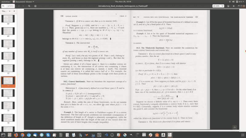

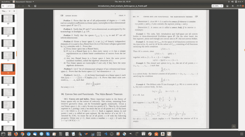

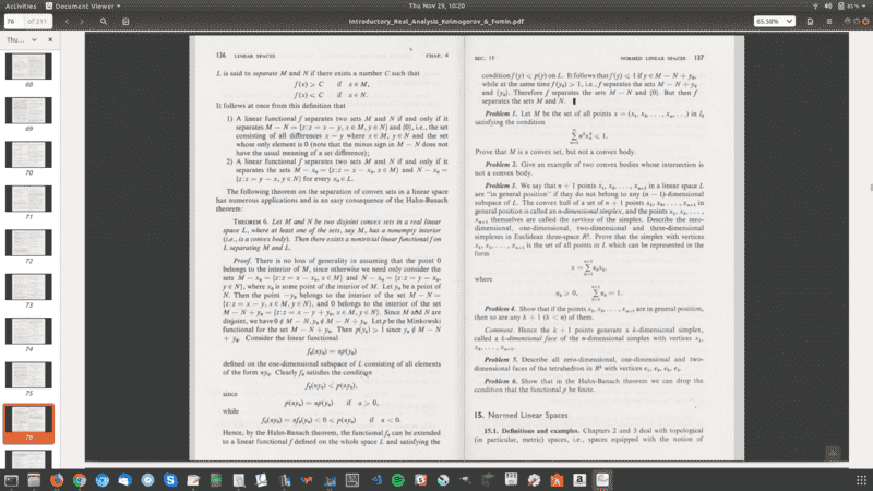

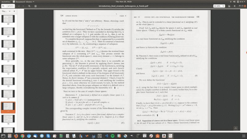

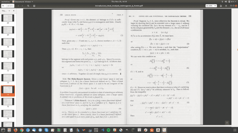

So I did a recourse through Kolmogorov's Real Analysis text and found Problem 5.c on pg 141. The interior of the unit sphere in any normed space is an open convex set, so for all points on the surface, a tangent hyperplane should exist in the sense that it never touches the interior.
