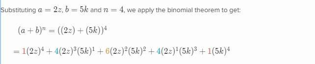

The problem comes in second term after 4(2z...)
so i got 4 (8z^3) 5k.
32 (z^3) * (20k). After that i left it like that but I supposed to get answer like this
160 z^3 * k
I can conjoin constants of z and k variables? Or am I missing something else

You are attempting to distribute multiplication over multiplication.
a×(b×c) ≠ (a×b)×(a×c)
Added in Edit:
To put it another way:
32 (z^3) * (20k) is just an extended multiplication. There is no adding going on.
32 (z^3) * (20k) is simply (32)⋅(z3)⋅(20)⋅(k)

4*8= 32 but where did the "20" come from? 4(8)(5)= 32(5)= 160.
