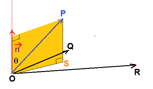

2.Also to find projection of OP I'll need angle POS but "S" co-ordinates are not known. I'm struggling to understand/imagine which angle will be needed for finding component of OP :(
The angle POS is the same as the angle the vector ##\vec{OP}## encloses with the normal vector ##\vec n##, see picture.

It is not wrong, but complicated.
Point P defines the position vector ##\vec {OP} = 3i -2j -k##
The scalar product ##\vec {OP} \cdot \vec n= |OP| |n| \cos(\theta) = |OP| \cos(\theta)## , is the projection of ##\vec {OP} ## on the direction of the normal vector, and it is the distance of point P from the plane OQR.

ehild said:
You need the unit normal vector of the plane OQR. You get a normal vector as the cross product of vectors OQ and OR, and dividing it by the norm, it is the normal unit vector pf the plane.The angle POS is the same as the angle the vector ##\vec{OP}## encloses with the normal vector ##\vec n##, see picture.It is not wrong, but complicated.
The scalar product ##\vec {OP} \cdot \vec n= |OP| |n| \cos(\theta) = |OP| \cos(\theta)## , is the projection of ##\vec {OP} ## on the direction of the normal vector, and it is the distance of point P from the plane OQR.View attachment 213409
Ok now everything is clear. Thanks
