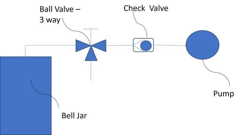

I would do something like this:
The ball valve should be vacuum rated, and I believe a "T port".

Sounds good to me. The only thing I'd worry about is the bell jar strength; but it will be fine if it's intended for vacuum use.
Just wear safety glasses.
I have used a safe plastic bell jar made by Nalgene, but expensive.
I did it as described above and it worked nicely. Thank you all for the quick and excellent help, as always.
