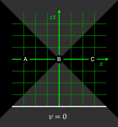

I am having a little bother with this and hope that someone will be able to explain it for me:doh:
If lightning strikes A & B simultaneously then, as those strikes are space-time 'events' they have no motion, only a time and a place. OK?
Then, as they also occur adjacent to points A' & B' on the train, and, if the light were reflected by mirrors attatched to those points, it would travel at 'c' relative to the train, in which co-ordinate system the observer at M' is not moving!:(
Therefore the two lightning strikes at A & B, A' & B', are also simultaneous to the observer on the train, as perceived by that observer:confused:
Einstein wrote that is the observer on the train
Then was he not saying that the lightning strikes were not simultaneous with respect to the train, as perceived from the embankment?:confused:
Grimble said:
Ref:http://www.bartleby.com/173/9.html"
No, you're equivocating a specific "time and place" with "spacetime event." A spacetime event is a specific geometrical location in spacetime, which to any given observer will be at a specific time and place. But different observers will *disagree* on the particular time and place of the event.
In other words, yes, spacetime events are specific locations in spacetime, but the actual x and t coordinates assigned to them by different observers will differ.
The example is meant to illustrate that the strikes cannot be simultaneous in both frames, because if the light flashes reach M simultaneously (a single event, since it happens at a specific time and place), then they cannot have reached M' simultaneously (since M' is not at M at the event when both signals arrive).
There is only one event where the light flashes meet, and in the example, this is given to be at observer M. Since observer M' is not at that event, the light flashes cannot have reached him simultaneously.
Since the light flashes did not reach M' simultaneously, even though he is equidistant from A' and B', where the lightning struck, he can only conclude that the flash at B' (=B) happened first. Thus in his reference frame the lightning flashes are not simultaneous. i.e., even though observer M assigns the same value of the time coordinate t to the two lightning flashes, observer M' does not.
I might add that you go off the track when you start with "If lightning strikes A & B simultaneously". There is no such thing without stating a frame of reference in which the two events are simultaneous.
In Einstein's example, the lightning strikes are simultaneous in the rest frame of the embankment, and therefore not simultaneous in the rest frame of the train:
"Are two events (e.g. the two strokes of lightning A and B) which are simultaneous with reference to the railway embankment also simultaneous relatively to the train? We shall show directly that the answer must be in the negative."
In fact they can't be simultaneous in the rest frame of the train if they're simultaneous in the rest frame of the embankment. Likewise, if another pair of lightning bolts struck A and B simultaneously in the rest frame of the train, then this second pair of lightning strikes would not be simultaneous in the rest frame of the embankment.
If the train stopped relative to the embankment, then the rest frames of train and embankment would coincide and be the same frame; only then could lightning strike A and B simultaneously in the rest frame of the train and the embankment. But the lightning strikes could only be simultaneous in all frames moving at some nonzero velocity relative to each other if the two bolts of lightning struck the same place as each other and at the same time as each other. This is what "relativity of simultaneity" means; in general, whether two events are simultaneous depends on which frame of reference they're described with respect to.
Yes, this is the source of a lot of apparent paradoxes. For the statement "A and B are simultaneous" to be meaningful, you have to say in which frame of reference they're simultaneous - because if they're simultaneous in one frame of reference, they won't be in others.

Grimble said:
Was he not saying that the lightning strikes were not simultaneous with respect to the train, as perceived from the embankment?:confused: [...] And again, if we were to consider the observer in the train, what does he perceive?
In the first example, lightning strikes A and B simultaneously with respect to a coordinate system in which the embankment is still and the train moving, but these strikes are not simultaneous with respect to a coordinate system in which the train is still and the embankment moving. An observer sitting on the embankment at M will see the flashes at the same time, whereas an observer sitting on the train at M' will see the flash from B before the flash from A. This is no illusion. In the latter observer's rest frame (the rest frame of the train), the lightning will really have struck B before it struck A, even though in the rest frame of the observer at M (the rest frame of the embankment), both strikes happened at the same time as each other.
It's completely cointerintuitive. I'm sure everyone finds this a confusing idea when they first encounter it.
In the second example, Einstein imagines a different pair of lightning strikes which happen to be simultaneous with respect to the train's rest frame, in which case they're not simultaneous in the rest frame of the embankment. In this example, it's the train passenger at M' who sees the flashes at the same time, while the person sitting on the embankment at M will see the lightning strike A before it strikes B. In this case, in the rest frame of the embankment, the lightning really does strike A first, even though the strikes were simultaneous in the train's rest frame.

Grimble said:
Lightning strikes points A & B which exist in both reference bodies.
Think of A and B as fixed points on the embankment. Both reference frames agree that the lightning strikes A and B, but the train frame will measure the positions differently. Think of a position A' fixed in the train that coincides with A at the instant the lightning strikes A; similarly, think of train location B' coinciding with B at the instant the lightning strikes B.
Observers in each reference-body will surely see the same effects with respect to their own reference-body; which, at the expense of repeating myself, is stationary with respect to that observer.
Not sure what that means.
The light will travel from A & B at the speed of light c relative to the observer's reference-body and so will meet at either M or M' depending on which reference-body the observer is in.
No. M' coincides with M at the moment the lightning strikes according to the embankment frame. Light traveling from A & B will meet at M, but not at M'. By the time that the light reaches M, M' has moved along.
It is all a completely self contained, symmetrical, set of circumstances.
Not symmetric at all.
From the above, please tell me how one can determine that one case is simultaneous and the other is not:confused:
The embankment frame sees the light go from A and B and meet in the middle at M. So they surely think that the lightning strikes were simultaneous. The train, on the other hand, sees the lightning striking at point A' and B' (equidistant from M'), but the light does not meet in the middle of the train at M'. So they must conclude that the lightning strikes did not occur simultaneously.
But not simultaneously in both. The example demonstrates how assuming that the strikes occur simultaneously in both reference frames leads to an inescapable contradiction.
The light does indeed travel at c relative to either reference body. Therefore, the fact that the flash from B' reaches M' before the flash from A' does requires that M' conclude that the strikes were not simultaneous.
No it isn't. You are forgetting the givens. The given is that the flashes reach M simultaneously. There is no such given for M'. The assumption of complete symmetry you are trying to make leads to a logical contradiction. That is the point of the exercise.
As far as I can see each would say that the lightning strikes were simultaneous for him but not for the other. What is it I am missing here:frown:
In the example, it is given that the flashes are received simultaneously by M. There is one event at which the world-lines of both flashes and M himself meet. Because all the worldlines meet at one event, all observers must agree that this event occurred. This is the basic assumption of reality in science: that observers might disagree on when and where an event happened, but they should always agree that it did.
Therefore, M' also observes that the light rays meet with observer M at a single event. If an external reality exists, this is it. There is no escaping this. Things that happen, happen. M' may label the "both light rays hit M" event with different coordinate values than M does, but it is one single event with one single set of coordinates in any particular reference frame.
Working in the reference frame of M, M observes the flash from B hit M' at a different time (different event) from the flash from A. Two separate events. Changing reference frames cannot possibly combine two different events into one. In other words, M observes that when flash A reaches M', flash B is not there at that event. When flash B reaches M', flash A is not there. When the two flashes meet each other, M' is not there. Merely changing reference frames cannot magically stitch all these different events together. M' therefore observes the flashes at two different times (two different events). He must conclude that the bolts were not simultaneous.
Summary: assuming that the bolts were simultaneous in M *forbids* them from being simultaneous in M'. Both observers agree on the events that occur: light flashes A and B reach M at a single event, and M' at two different events. All observers in the universe must agree that both light flashes and M meet at some event, while M' meets the light flashes separately at two different events.
You could do the same argument starting from the assumption that the flashes reach M' simultaneously, which would forbid M from seeing them simultaneously, but that would be a different universe. The two situations would be two completely different sets of events. Only one of them can occur, not both.
EDIT: And I should add, that since the given is that the light rays reach M simultaneously, and not that the bolts were simultaneous in all frames, that the correct calculation to make in the M' frame would be to ask when the bolts must occur in order for their flashes to meet at M, NOT at M'. Since M is traveling backwards, bolt B must occur before bolt A in order for the flashes to meet at M as given.

This phrase doesn't make any sense to me. How can they both "agree that it was simultaneous" if it was only simultaneous in the viewing frame? If the events aren't simultaneous in the train frame, then by definition both frames do not "both agree it was simultaneous". When physicists use anthropomorphic language about frames, like talking of frames making judgments or agreeing about things, they do not mean to imply that frames can "think" about any other frame besides themselves and form opinions about what is true in that other frame; a "judgment" made by a frame is just a fact which you arrive at by making an analysis that involves the coordinates of that frame alone, like the judgment that two events are simultaneous in that frame (they happen at the same t-coordinate), and for two frames to "agree" on something just means that a thing which is true when you analyze it from one frame's perspective is also true when you analyze it from another frame's perspective. So it would be stretching the anthropomorphism to the point of absurdity to talk of frames making "judgments" about what is true in other frames besides themselves, or of two frames A and B "agreeing" that two events are simultaneous in A (even though they are not simultaneous in B). Trust me, physicists never talk this way.
Grimble said:
Neither frame would be in any way a preferred frame;
If different frames made different predictions about whether the light from each strike would reach the observer at the center of the train at the same moment or at different moments (a disagreement about whether two events happen at the same local point in both space and time), then surely you agree only one frame's prediction can be empirically correct, and whichever one had made the correct prediction would be preferred over the one that made the incorrect prediction? Again consider the apparatus I imagined in the earlier post:
Similarly with the train thought experiment, it would be easy enough to put a small device at the center of the train which would sound an alarm (or set off a bomb) only if light detectors on opposite sides of the device detected bright light simultaneously (the detectors could convert light above a certain threshold into electrical signals which would be channeled through an AND gate, for example)--if different frames made different predictions about whether this device goes off, it would be easy enough to check which prediction was correct and thus establish a preferred frame, since again they couldn't both be right.
Hello Grimble,
This may be of some use.
Consider the scenario where the strikes are simultaneous in the embankment frame. We know they are simultaneous in the embankment frame because the light from the strikes meets at the location of an observer, on the embankment, midway between the points where the lightning struck. This is the requirement for simultaneity.
Now consider an observer at rest in the train frame at the mid point of the train, which is also midway between the points at which the lightning struck. He will not consider the strikes to be simultaneous in the train frame because the light from the strikes did not meet at his location as would be necessary for the requirements of the definition of simultaneity to be met.. HOWEVER, with the information available to him, and with an understanding of the postulates of relativity, he can calculate that the events WERE simultaneous in the embankment frame. So we could say that that although the strikes were not simultaneous in both frames, observers in both frames can conclude that they were simultaneous in the embankment frame. The opposite applies if the strikes were simultaneous in the train frame.
As a little extra comment, which can be ignored for the present purposes if it in any way adds to the confusion, any observer at any point at rest in the embankment frame can, by knowledge of data which is available to him, also conclude that the strikes were simultaneous in the embankment frame but not in the train frame. The observer does not have to be at the mid point between the strikes to be able to decide upon simultaneity. The same reasoning applies with regards to the train frame.
Matheinste
Thank you, both, that is a great help to understand what you are saying, I must re-think and understand it now.
Grimble:smile:
