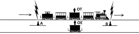

lukka98 said:
i think light will arrive at OT at the same time also in his frame of reference, if i don't observe that i think light speed is greater than c from B to OT and lower from A to OT,
You're correct. In OE's frame, the closing speed from B to OT is greater than c. Call the speed of the train v. In OE's frame, light reaches from B to OT at a rate of c+v.
  • #216
lukka98 said:
Summary:: My question is about on of the "famous" Einstein's mental experiment: the train and the lightnings, i don't understand why the result is what it is, I thought for day but I don't understand this particular case, If you can help me to understand I'll very grateful.
(excuse me for my english, but I'm studying physics and I am not a native English speaker)
One observer OE, is on the ground, we take him as the fixed frame of reference.
The other OT is on the train that is moving relatively to the OE at a costant velocity ( they are both inertial frame of reference).
So, two lighning strike the two points A and B when the train is with back and end in the same points ( A and B) and the two observer are aligned.
Stop right here. If one observer thinks that the two ends are aligned at the same time, then the other observer must think that the two endpoints are aligned at different times. If it is simultaneous for one, it can not be simultaneous for the other. Is that fact included in your logic?
(In fact, if one observer thinks that the endpoints and the observers are all aligned at time t=0, then the other observer thinks that all three alignments happened at different times.)
  • #217
Chris S said:
OT observes the light from each lightning strike at different times because OT was no longer at a location equidistant from both lightning strikes at the time the light from both strikes reached OT.
Assume strikes A and B are simultaneous in your frame, and you are midway between the strikes when they occur, but you are closer to B and farther from A when the light reaches you. Would you conclude the strikes are not simultaneous in your frame?
  • #218
@lukka98
Have a look at post #30, which refers to a diagram that I posted in another discussion , one year ago . Look at the diagram.
Both OE and OT know that c is the same in all inertial reference frames; OT is reached by the light coming from B before than the light coming from A; (of course OT uses his time t’) .
Therefore, he concludes that event B happened before event A , in his reference frame.
Einstein tells us that both OT and OE are right. Events A and B are simultaneous for OE, so they aren’t simultaneous for OT.
