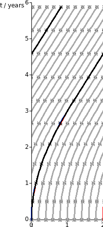

There is an alternative that I’ve never seen worked out for this case. That is, using radar coordinates based on one train car. @Dale recently posted a paper that established that in SR, radar coordinates can consistently cover the intersection of the causal future and causal past of an origin world line. Thus, for eternal uniform acceleration they have the same coverage (and foliation) as Rindler coordinates. However, for this case, the spiral world line of a single train car has all spacetime in both its causal past and causal future. Thus, radar coordinates should have global, consistent coverage. How useful they would be is another matter ...
I found this paper particularly interesting because it greatly generalized something I had worked out on my own - that radar coordinates have global coverage for any world line that is inertial in the past of some event, and also inertial in the future of some event, no matter what happens in between, or what the relative velocity is between the past inertial part and the future inertial part. Clearly, this is a very special case of the more general result of this paper.
Likes Dale
Here is that paper:
https://arxiv.org/abs/gr-qc/0006095
The directly relevant section is figure 3 and the associated text and equations.
Likes PeterDonis

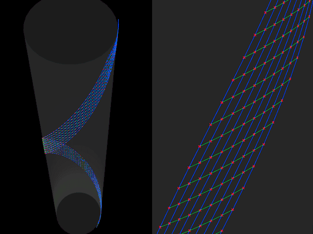

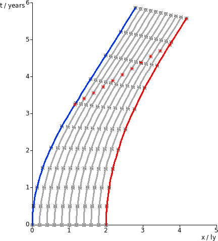

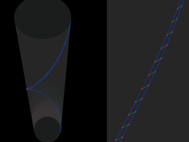

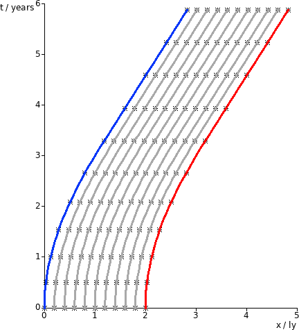

To all,
I noticed that no one denies that the printing of the front clock should be ahead of the printing of the rear clock, except that it is hard to define the proper frame for it. I think it is agreed that it is valid in the co-moving frame of a similar single wagon, when we provide that the only difference to one of the train carriages is that it moves on a straight rail. But what I understand from your comments is that a non-zero centripetal acceleration - on such an originally inertial single wagon - is the decisive game-changer.
Still, it means that (taken for granted that every clock does only one printing and that there is rotational symmetry) every single clock on the train has two different readings in the sequential frames it is acting in (as a front clock and as a rear clock), no matter how similar these sequential frames are, apart from the difference in moving direction. I just don’t see how that is possible. If two sequential wagons would both move straight on in the same direction, there would be no different readings, but bring them to even the slightest centripetal acceleration and suddenly the difference in readings is there in its full extent. The size of it is not even dependent of the degree of acceleration.
PeterDonis said:
No. You are not just talking about general properties of clock synchronization conventions. You are talking about a very specific clock synchronization procedure: Einstein clock synchronization. That greatly restricts what can be done.

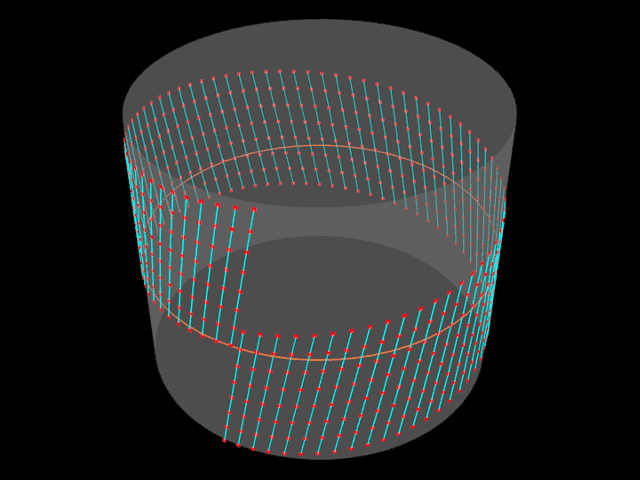

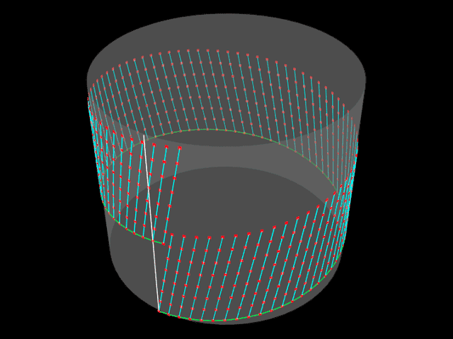

I have to say that I don't see the problem with what I'm saying, except for DrGreg's point about the difficulty of extending off the track. It's not clear to me whether we're talking at cross-purposes or if there's something I'm just not understanding, so I thought I'd draw some diagrams. Below is a (2+1)d Minkowski diagram drawn in the rest frame of the circular track. The right hand half is just a detail from the left hand half.
246089
The translucent cylinder is the worldsheet of the track - coordinate time obviously runs parallel to its axis. A single carriage is going round the track, equipped with clocks at the front and rear - the worldlines of these clocks are marked in blue. Clock ticks are marked as red crosses, and "simultaneous" ticks are joined by green lines. The definition of simultaneity in use here is that the clocks are synchronised in their instantaneously co-moving inertial frame. Thus, where they form an acute angle, a blue line and a green line form two legs of a tetrad. I don't think there's any problem with this. Both clocks have the same speed in the frame shown, so tick at the same rate and (once initialised) maintain this synchronisation without further intervention.
All I was suggesting was that you can chain this process together along the train - using the front clock as the rear clock in the next carriage, and so on. Eight carriages looks like this (again, the right is a detail of the left):
246090
Obviously you have to have a break somewhere because, if I added enough carriages to complete the circle, the green lines wouldn't close. And you and DrGreg already explained why I can't extend this off the surface of the cylinder. But I don't see why this won't work along the length of the train. It isn't a global Einstein synchronisation, and I wasn't saying it was (or certainly wasn't intending to say so if I did). What it is is a chain of clocks, each of which is Einstein synchronised (in a slightly different frame) to each of its two neighbours.
No. How you choose to synchronise your clocks is a game-changer. The way you've set it up they remain synchronised in the rest frame of the track. This is not the same as the synchronisation used by the instantaneous inertial rest frame of a carriage.
So in the rest frame of the track, your printers print simultaneously. An inertial observer passing by, instantaneously at rest with respect to a carriage, will say that the printers at the ends of the carriage printed at different times and all the printers in other carriages printed at yet other different times.

Building on my earlier post, I've constructed Minkowski diagrams for a train circling a track at constant speed. Unfortunately my arithmetic must have gone wrong somewhere because the train has a small gap between front and rear. I don't think this makes much difference to anything.
246166
Again, the diagram is drawn in the rest frame of the circular track, the worldsheet of which is the translucent cylinder. Pale blue lines show the worldlines of clocks distributed evenly along the train (and you can see the small gap because the last line doesn't quite line up with the first), with red dots marking their ticks. One set of "simultaneous" red dots are joined by a green line - simultaneous, here, means in the sense that a clock is Einstein synchronised to its neighbours in the inertial frame in which they are instantaneously at rest. I've also added a white line, which is the worldline of an observer at rest in the track frame.
Note that if these clocks are equipped with printers and print at the green-connected times, then in the track frame they print one after the other. Thus the movement of the train means that when the last-to-print clock prints, it isn't in the same place as the first-to-print clock was when it printed, and the ends of the dot pattern thus printed overlap.
The above is not the scenario outlined in the OP. In the OP, all of the printers print simultaneously in the track frame (in contrast to earlier threads by the same poster). I've illustrated that circumstance below.
246167
Note that this diagram is identical to the above, except that I deleted the green line and added an orange line that marks simultaneity in this different sense. If the clocks print at the time indicated by the orange line then there is no overlap and the dots printed on the track are uniformly separated (except for the one small gap, in this diagram). The orange line lies in a plane of simultaneity for the trackside observer, but note that it does not pass through a line of red dots. Thus observers on the train would not regard the printers at opposite ends of a carriage as printing simultaneously, assuming they adopt their instantaneous rest frame's simultaneity convention (life gets complex beyond the end of a short carriage because we haven't truly defined a generally applicable simultaneity convention for the on-train observers).
It has to be stressed that these two diagrams are (very nearly) identical, representing identical physical situations in terms of trains on the track. The only difference is the rule we use for defining "at the same time" in the sentence "the printers print at the same time". And the rule to use is a matter of choice by the experimenter.

Turns out to be too many tools in my workflow. I simplified a bit - still don't know quite what I did wrong, but the numbers going into the generation process were wrong. Corrected results are below:
246190
No comments to add to my previous, except now you can see that the front of the train is coincident with the rear. Using the green "chain of local Einstein synchronisations" makes the pattern overlap due to the motion of the train while the printing happens. Using the orange "synchronised in rest frame" criterion for printing makes the pattern even, but adjacent clocks do not print simultaneously according to an observer in the carriage.

Next, here is a diagram of a train accelerating so that the distance between the carriages remains constant for observers on the train. It's fairly easy to see that this requires the train observers to be a family of Rindler observers with shared horizons.
246260
As before, clock ticks are marked with crosses. They are initially synchronised in the track frame but, due to different velocity profiles, they de-synchronise during the acceleration. Because the requirement is that the final velocity be the same along the train, the carriages stop accelerating at different times - these are marked with red crosses. Note that, in the way I've chosen to set this up, the blue clock behaves identically to the blue clock in the first diagram. You can also see that the train is undergoing length contraction.
It's also interesting to see the above in the final rest frame of the train:
246261
You can see that the carriages stop accelerating simultaneously in this frame, but their clocks are not synchronised. You can also see that the separation of the carriages after the acceleration is, in this frame, the same as it was before in the track frame, as promised.
Finally, why am I talking about this linear track? It's because the surface of a cylinder has the same geometry as a plane, albeit with a different topology. So you can simply wrap these diagrams into cylinders with the t-axis parallel to the cylinder axis to get cylindrical diagrams like the ones I posted before. Or one can imagine slitting the cylinders parallel to their axis and spreading them out to get flat diagrams.
Because the original problem specification was that the train exactly fitted around the track, in either of the first two diagrams we can simply cut off everything to the right of ##x=2## and paste it on to the left to get a Minkowski diagram of the "unwrapped" cylinder. So at the start of the experiment the red and blue lines are coincident, and anything that passes ##x=2## moves to ##x=0##. Here, then, is the version keeping constant acceleration in the track frame:
246262
The red and blue lines are initially coincident and remain coincident (this has been rendered as black by the colour-combining process I used). You can see that the clock ticks always remain simultaneous in the track frame, as they must from the symmetry of a situation where every clock does the same thing in this frame.
What about the case where the train is free to keep its natural length? That looks like this:
246263
Here we can see that a gap opens up as the train length contracts and the clocks de-synchronise.
In both cases, if the clocks were re-synchronised after the acceleration, their "same time" ticks would look like the red events - non-simultaneous in the track frame. Note that the string of red events goes all the way around the cylinder and a little bit more, so if these were used to time printing then the end of the pattern would overlap the beginning.
So here's the takeaway message: the clock synchronisation you get is your choice. You can re-synchronise your clocks by some procedure after the acceleration, or you can accept whatever you get from synchronising pre-acceleration. The results of either approach will differ depending on the exact physical situation (which is also your choice!)
