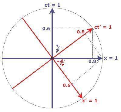

Here's something that puzzled me for some time: why are space-proper-time (SPT) diagrams not used more frequently? I did search this forum for the term, but without success. It may be known under some other technical term that I don't know about.
I'm using the term with the meaning as per Lewis Carroll Epstein's "Relativity Visualized", where the orthogonal axes of two inertial coordinate systems in relative motion are simply rotated by an angle phi = asin(-v/c) relative to each other, as shown in the attached figure for a relative velocity (red coordinates relative to blue coordinates) of v = 0.8c.
I originally thought that SPT diagrams represent a weird combination (as Kip Thorne wrote) of "my space and your time" but the more I toyed with SPTs, the more useful they seemed. I think one problem is that SPT diagrams cannot show space-like intervals, but for time-like intervals, they seem to be much easier to picture and use than Minkowski space-time diagrams.
For one thing, the calibrating marks on the two sets of orthogonal axes have identical lengths. Other benefits that I can think of include:
i) Time dilation and Lorentz contraction are both read off directly by projecting one coordinate system's proper-time intervals or space intervals onto the other system.
ii) It shows the freedom of choice of reference system very clearly - no preferred frame is remotely suggested - just rotate the chart!
iii) A straight vector summation of a space interval and a proper-time interval gives a "space-proper-time interval" that is invariant under change of inertial frames. There may be an official term for this interval, but I don't know it.
iv) Maybe more…
Apart from space-like intervals, I still have to find a situation that cannot be represented on the SPT diagram. I know that here velocity additions cannot be done by adding angles as in the rapidity case, but still…
So where's the catch? I fully expect to be hand-slapped for suggesting that SPT diagrams could be useful, but I simply must know "if not, why not?" :wink:

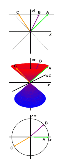

This picture
illustrates how your proper-time-space diagram relates to the lightcone and Minkowski diagrams. It also shows where the space-like intervals have gone. Note that the cone in the picture is not the lightcone.
(from Hans Montanus: Proper Time Physics, Hadronic Journal 22, 625-673, 1999)

Hi Mortimer,
I'm afraid I do not understand the relationships (I must say the diagrams come out a bit tiny on my computer). If you can, give a bit more info. Otherwise I will try to locate the document that you referenced.

For a chosen x-axis in the Minkoswki diagram, the [itex]c \tau[/itex]-axis is added perpendicular to the x-ct plane, kind of as a 5th dimension. A worldline in the Minkowski plane can now be projected in the direction of the [itex]c \tau[/itex]-axis to the cone in the picture. From the projection, one can directly read the [itex]c \tau[/itex] value. The relation is the classic one: [itex](c \tau)^2=(ct)^2-x^2-y^2-z^2[/itex]. An acceleration, which shows in the Minkowski diagram as change in inclination of the worldline, will show in the x-[itex]c \tau[/itex] plane as a rotation along the edge of the cone.
The articles of Montanus are a bit hard to come by. You can find a scanned copy of the referenced article http://home.hetnet.nl/~f2hrfjvanlinden171/Montanus-ProperTimePhysics.pdf" (11MB !).

Agreed for the Loedel/Brehme diagrams with their oblique reference frame axes. The space-propertime (SPT) diagram has regular orthogonal axes and IMO it does not suffer from this "catch".
However, the SPT diagram may have other catches, apart from the fact that it's a 'non-standard' representation.
Jorrie
I must have missed something. What exactly is the difference between a Loedel diagram and a SPT? Is the diagram you posted initially labeled correctly?
Gone with SPT!
Yep, it was labelled correctly as far as SPT diagrams go... i.e., orthogonal axes pairs (rotated) and not an oblique reference time axis like Loedel/Brehme.
But, I can now see that, without awkward manipulation, such a scheme (SPT) cannot give you the Lorentz transformation of space- and time intervals between two inertial frames in relative motion. So that is the SPT catch, a fatal one, I think!
Jorrie
Ah, I see. Maybe a slightly modified SPT diagram could be useful to explain ordinary rotations to your engineers? :-p
