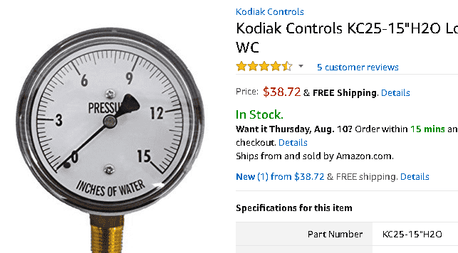

But for more exactly what you asked
Gersty said:
Are there gauges available to read the pressure at the bottom of each tower?
try a search on "inches of water pressure gage"
my first hit

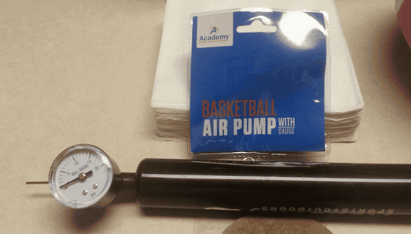

I don't know where you are with this project. I was at Academy sporting goods, and purchased this pump with pressure gauge for $6.99, and I was reminded of your project, as the ball that I need to inflate recommends 4 to 6 psi, and this gauge seems to do the trick.
