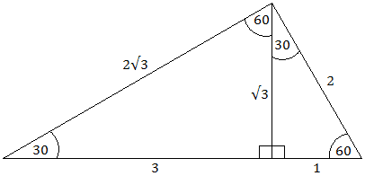

Have you ever heard of the 30-60-90 triangle? If I put two of those together, I end up with your triangle:
Where every side is proportional to each other by those constants.
Having this information, finding the length of the hypotenuse as a function of the perimeter is a walk in the park:
[itex]h = \frac{2P}{3+\sqrt{3}}[/itex]
Where h is the hypotenuse and P is the perimeter.
There is no need to make things more complicated than they really are! Ask if you have any questions.

Well, that's a very nice solution but is it a solution to the problem presented? I ask because I can't figure out why it is that you are confident that the triangle IS a 30/60/90. I can't see any such constraint.
I agree that it may be the solution for this particular case but not for all cases. The formula must cover all possibilities with one angle of 90 and the other two having a sum of 90.
The simpeler the solution the better but this is too simple in my opnion.

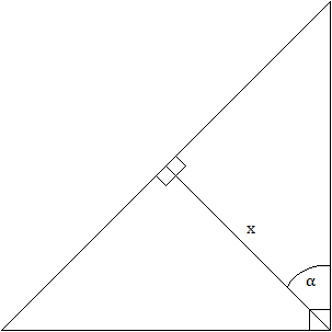

With what I said above, I simply wanted to point out the important fact that, regardless of their set-up, the triangles will remain proportional to each other by a certain constant which depends on one of the angles.
But since you apparently want an answer to this problem, I will have to post it:
[itex]h = \frac{\sqrt{tan^{2}\alpha + 1}}{\sqrt{tan^{2}\alpha + 1} + tan\alpha + 1}P[/itex]
It is still a simple solution, in my opinion.

Hurkyl already helped me check my answer which turned out to be right before you started posting so what makes you think i need an answer? I already proofed that h = [itex]\frac{p^2}{2p+24}[/itex]. Maybe first read what the question is before fireing away.
It's not that i don't appreciate help but i'd more appreciated it if you had read the postings before
grtz
Ivar
ps for P = 24+24*2^2 both formulas return 24 (with angle Pi/4 and x = 12, P = 24+24*2^2) but your answer still is wrong cause alpha should not be in the formula. h as a function of p was asked. Fun though that two completely different approaches give the same result
You are right. I apologize.
