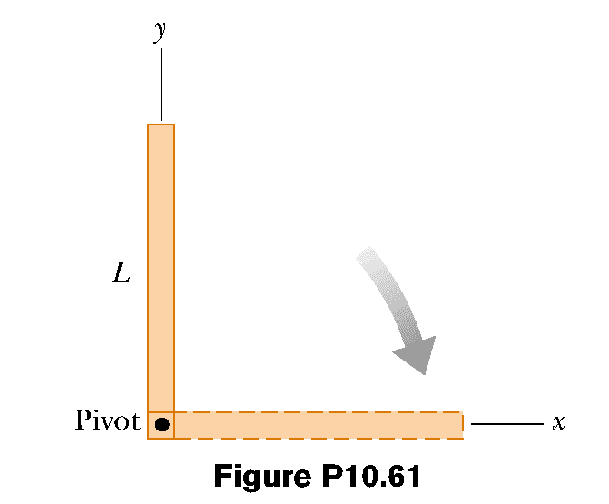

I am trying to solve this problem. I already got the answer but have some questions.
A long uniform rod of length L and mass M is pivoted
about a horizontal, frictionless pin through one end. The
rod is released from rest in a vertical position, as shown in
Figure P10.61. At the instant the rod is horizontal, find
(a) its angular speed, (b) the magnitude of its angular ac-
celeration, (c) the x and y components of the acceleration
of its center of mass, and (d) the components of the reac-
tion force at the pivot.
I got parts a,b,c and I am trying to do part d. Now I reasoned that, when the rod is rotating,
there will be two reactions at the pin. Since the motion of the rod at the pin is prevented in x and y directions, in free body diagrams, there will two forces, f1
in an upward, y direction, and f2 ,in the horizontal x direction.
And there will be weight, mg acting downwards at the center of mass. Let L be the length of the rod. Now from part a,b,c I got x and y components of the acceleration of the center of mass (the usual tangential acceleration).
[tex]a_{tx}=\frac{3g}{4}\sin \theta \cos \theta[/tex]
where [tex]\theta[/tex] is the angle made by the rod with the vertical direction. so above acceeleration is directed to the right. And the downward y component is
[tex]a_{ty}=\frac{3g}{4} \sin^{2}\theta[/tex]
I got the answer to the part d by setting up Newton's second law equations in x and y directions. But I tried to use another approach of setting up torque equations, and there was a problem. I reasoned that , angular acceleration, [tex]\alpha[/tex] would be same around any axis . The value of , [tex]\alpha[/tex] , I got was
[tex]\alpha=\frac{3g\sin \theta}{2L}[/tex]
Now first let me write the values of f1 and f2 I got from solving
translational equations of motion for the center of mass.
[tex]f_1=mg\left[1-\frac{3}{4}\, \sin^2 \theta \right][/tex]
[tex]f_2=\frac{3mg}{4}\, \sin \theta \cos \theta[/tex]
Now I set up the equation for rotational motion around the axis passing through the other free end of the rod.
[tex]\tau=(mg\sin\theta)\frac{L}{2}-(f_1 \sin \theta)L+(f_2 \cos \theta)L\cdots (1)[/tex]
but [tex]\tau=I(-\alpha)[/tex]
where I is the moment of inertia around the axis passing through the other end. So
[tex]\tau=-\frac{1}{3}mL^2\alpha[/tex]
Now when I equate the two expressions, I get
[tex]\frac{1}{3}mL^2\alpha=(f_1 \sin \theta)L-(mg\sin\theta)\frac{L}{2}-(f_2 \cos \theta)L[/tex]
Now I used the original value of alpha and simplified it.
[tex]\frac{3f_1}{mL}\sin \theta - \frac{3f_2}{mL}\cos \theta=\frac{3g\sin \theta}{L}[/tex]
Now if I plug in the values of f1 and f2 in the above expression
, I end up with 1=0, which is wrong.
When I use the axes passing through the pin and the one passing through the center of mass
, I don't get this problem. When I choose an axis passing through any point beyond the
center of mass towards the other end, I get some problem. So I am suspecting that
there is something wrong in the equation 1. Can you see that ?
