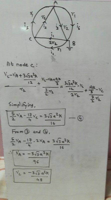

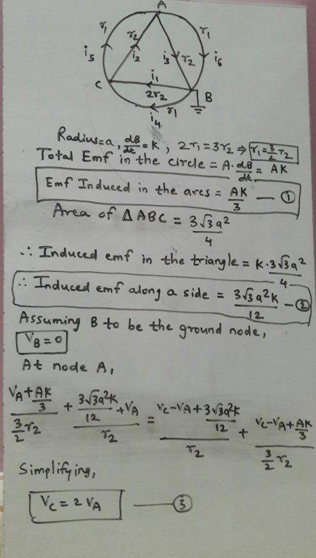

Here's how you can do it using node voltage method at nodes A and C.
@cnh1995 's method uses that the current into a node is the current out of the node. In addition it uses the current in any resistor wire is
## I=\frac{\int\limits_{X}^{Y} \vec{E}_{total} \cdot d \vec{l}}{R} ##,
where ## \vec{E}_{total}=\vec{E}_{induced}+\vec{E}_{electrostatic } ##, and where
## \int\limits_ {X}^{Y} \vec{E}_{induced} \cdot d \vec{l}=\mathcal{E}_{XY} ##,
and
## \int\limits_{X}^{Y} \vec{E}_{electrostatic \, XY} \cdot d \vec{l}=V_{XY} ##.
Alternatively, KVL uses ## \\ ##
## \oint \vec{E}_{induced} \cdot d \vec{l}=I_1 R+I_2 R +...=\mathcal{E}_{loop} ##,
since ## \oint \vec{E}_{electrostatic} \cdot d \vec{l}=0 ##.
(## \vec{E}_{electrostatic} ## is a conservative field, unlike ## \vec{E}_{induced}##).
Wit the above method, knowing that ## \mathcal{E}_{arc}=\frac{ \pi Ca^2}{3} ##, and knowing that
##I_1=\frac{\pi Ca^2}{3 r_1}-\frac{\sqrt{3} C a^2}{32 r_1}=\frac{ \mathcal{E}+V_{AB}}{r_1} ##,
we quickly get the answer that
## V_{AB}=-\frac{\sqrt{3} Ca^2}{32 } ##.
The EMF can also be computed over the straight line path over one of the sides of the triangle to be
## \mathcal{E}_{side}=\frac{\sqrt{3} C a^2}{4} ##. The current on this side of the triangle is
## I_2=\frac{21 \sqrt{3} C a^2}{64 r_1} ##.
This gives, with ##R=\frac{2 r_1}{3} ## that
## I_2 R=\frac{7 \sqrt{3} Ca^2}{32 }=\mathcal{E}_{side}+V_{AB} ##.
Note ## V_{AB} ## is electrostatic and thereby path-independent.
Once again we get
## V_{AB}=-\frac{\sqrt{3} Ca^2}{32} ##.
