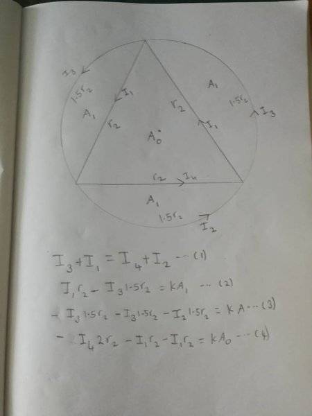

Letting ## C=\frac{dB}{dt} ##, I get the EMF for the 3 outer circular arcs is ## \mathcal{E}_o=\frac{C \pi a^2}{3} ##, and (assuming I computed it correctly), I get the EMF for each of the three straight line segments is ## \mathcal{E}_i= \frac{C \sqrt{3} a^2}{4} ##. It should be a simple matter to then compute all of the currents, using Kirchhoff's laws. It requires 6 loop equations. There are 6 currents to solve for. ## \\ ## @vanhees71 I will try to double-check my calculations, but might you concur?
  • #152
I think I have complete solution, but it would be easy to have mistake. Going clockwise around the outer loop, starting with CA, and calling currents ##i_1,i_2,i_3 ##, and similarly around the triangle, ##i_4,i_5, i_6 ##, I get ##\\ ## ##i_1=\frac{9}{2}M-\frac{7}{8}N ## ##\\ ## ##i_2=\frac{45}{2}M-\frac{35}{8}N ##
## i_3=6M-\frac{5}{4}N ##
## i_4=\frac{21}{4}M-\frac{21}{16}N ##
## i_5=\frac{-51}{4}M+\frac{35}{16}N ##
##i_6=\frac{15}{4}M-\frac{15}{16}N ##
where
##M=\frac{D}{r_1} ## and
##N=\frac{9E}{2 r_1} ##
where
## D=Ca^2(\frac{\pi}{3}-\frac{\sqrt{3}}{4}) ## and
##E=Ca^2 (\frac{\sqrt{3}}{4}) ##.
My solution might contain errors, but this is what I got in solving the 6 loop equations. ===============================================================================
Corrections (3-27-19):
##i_1=i_2=M+\frac{7}{36}N ##
##i_3=M+\frac{5}{18}N ##
##i_4=i_5=+\frac{7}{24}N ##
##i_6=+\frac{5}{24}N ## (Note: I corrected ##I_4,I_5,I_6 ## a second time at 7:30 PM 3-27-19 and corrected again 3-28-19 at 10:45 AM where I had the sign on N reversed.).

  • #169
As per my calculations, the "electrostatic" voltage VAB= VA-VB= -3sqrt(3)a2k/96.
(Here, k=dB/dt as mentioned in the OP).
Electrostatically, B comes out to be at a higher potential than A and C.(PS: How do I type mathematical signs and symbols here on PF5? I don't see any option in the editor.)
Edit: I verified the above result with actual numerical values as follows:
Radius a= 10m, k= 5T/s, r1= 15 ohm, r2= 10 ohm (2r1=3r2).
All the six currents are satisfying KCL at the 3 nodes (total incoming node current= total outgoing node current = 52.046 A).
Typing the entire solution here would be a tedious task. Let me know if you want to see the full solution. I will try to post an image of the whole solution.
Thank you @cnh1995. I would love to see a summary of your approach a la my post 149. Did you have 18 equations & 18 unknowns, what are they, etc. I'm not interested in quantitative results since I don't have any myself (I am too lazy to compute things like areas and triangle lengths :sorry: ). The approach is what's interesting to me. Thanks.
  • #175
Nah, just 2 equations with 2 unknowns!:smile:
Will add you in an ongoing conversation as I am not sure if I can post the "complete" solution here in the HW thread.
@cnh1995, did you verify that the line integral of Es is the same for both the arc and the triangle side?
