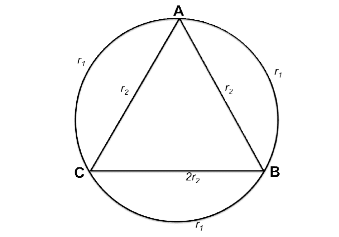

timetraveller123 said:
yes the em has no regard for the actual setup
this also why the horizontal segments has no em
as it is pointing radially away(i am assuming)
Thanks, that's great, I suspected this might be a valid assumption, should have invoked it here.
then as to the pdf file that rude man attached i think the solution follows in the same way as there will definitely be build up of charges at the junctions hence the solution follows in almost exact manner
\frac{emf}{4r}+\frac{v}{2r} = I\\
\frac{emf}{2r} - \frac{v}{r}=I\\
v = \frac{emf}{6}
as to what the voltmeters read in both the questions i am not sure voltmeters are screwing with my brain
Exactly what I got for Vab. Your brain is working just fine.
V1 and V2 turn out to be just current times resistance. As I'm sure you'll discover also.
rude man said:
Perhaps you may wish to respond to the attached pdf file.
The OP should also think about it. I have the answers but will withhold them until a response is received.
What do voltmeters VM1 and VM2 read?
VM1 = -i*r
VM2 = i*2r
Easy application of Faraday's Law and Ohm's Law.
What is Va – Vb? There can only be one answer!
Voltage and potential is not really defined in a non-conservative field so there is no one single correct answer to this question.
But I think the most sensible answer is that the voltage is path dependent.
Go back to the real definition of voltage: "The voltage between two points a and b is the work per unit charge required to move a small test charge from a to b"
The work going from b to a is different depending on if you go to the left or to the right of the magnetic field.
Note that since there is no B field outside the yellow region, the actual path does not matter - the only difference is if you go to the right or to the left.
So, the voltage is either -i*r if you go on the left side, or i*2r if you go on the right side.
Think of this like walking in a hurricane.
There is a wind blowing clockwise around the circuit. If you walk on the left you have the wind in your back so the work required is negative.
If you walk to the right you have the wind in your face so you have to work really hard to get to the same point.
A circular coil with radius a is connected with an equilateral triangle on the inside as shown in the figure below. The resistance for each section of the wire is labeled. A uniform magnetic field B(t) is pointing into the paper, perpendicular to the plane of the coil. B(t) is decreasing over time at a constant rate k. Given 2r1 “ 3r2. Find UAB, the potential difference between points A and B
It's been a long grind, 1 1/2 years old or so, yet no one has IMO solved the OP's problem. I hereby submit a method of solution but won't carry out the computations as they are laborious and probably inappropriate anyway.
We recognize that the voltage between A and B is the line integral of the static electric field Es between those points. Any emf-generating field Em is irrelevant. The procedure is to solve for all fields in the six separate segments 1-6.
There are 18 parameters to be found (we need only 1 of them but we have to set up for all 18). They are:
Currents i1 - i6 in the 6 segments (3 arcs of 120 deg each plus 3 triangle sides),
Em in the 6 segments,
Es in the 6 segments.
We first find the 6 Em fields. This is readily done by constructing three dashed radii orthogonal to the triangle sides as shown. This enables easy computation by Faraday of for example Em1 in AY since Em is known in arc AX and = zero in XY. emf is obtained from the area AY-AX-XY. Etc. So the six Em are found immediately.
Next, 4 equations for Es are available. They are, by Kirchhoff voltage law (yes, Kirchhoff was right!),
(2##\pi##a/3)Es1 - L Es4 = 0
(2##\pi##a/3)Es3 - L Es6 = 0
(2##\pi##a/3)Es2 -L Es5 = 0
Es4 + Es5 + Es6 = 0
with L = length of one side of triangle.
Then, we invoke Ohm's law for E fields to get 6 more equations of the form Em+Es= i dr/dl. These are thus
## Em1 + Es1 = i1(3r1)/2\pi a ##
## Em2 + Es2 = i2(3r1)/2\pi a ##
(r1 is resistance of 1/3 of circumference)
etc.
Em4 + Es4 = i4(r2)/L with L = triangle side length,
Em5 + Es5 = i5(2r2)/L (since side BC has 2r2 resistance).
etc.
The final 2 equations are of the type i1 + i4 - i3 - i6 = 0 etc. in other words Kirchhoff current sums at A and B.
So we have 18 unknowns and 18 independent equations, allowing for finding Es1 (and/or) Es4. So UBA = ##2\pi aEs1/3 = L Es4 ##.
