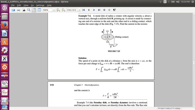

Griffith, electrodynamics
In page no. 304,
Griffith defines e.m.f as ξ = ##\oint f.dl ##,
and he says that e.m.f. is the net effect of the mechanism which drives the current in the circuit.
And after some calculation it turns out that this e.m.f. is equal to the potential difference across the battery.
But conceptually e.m.f. and potential difference are two different things.In page 305, just above the equation (7.11),he says the following
If the entire loop is pulled to the right with speed v,
the charges in segment ab experience a magnetic force whose vertical component
qvB drives current around the loop, in the clockwise direction.
This means that it is the magnetic force which pushes the charges up, right?
And so the magnetic force is doing the work.
In equation (7.11) he derives e.m.f. as line integral of magnetic force.
Then, he says that magnetic force does no work. It is the person who is pulling the loop is doing the work on the charge.
Then, he says that the emf is equal to this work done per unit charge. But, the emf and the work done per unit charge are conceptually different.
Now, my question is : Is work done per unit charge always equal to the e.m.f. ? I am this because calculating e.m.f. is easier than calculating work done per unit charge.
While in page 30 9, he uses emf as potential difference for calculating current.
So, can anyone please tell me the physical significance of e.m.f.?
I think practically, in any circuit , I can calculate e.m.f. and then take this emf as work done per unit charge i.e. potential difference for further calculation.
Is this correct?
