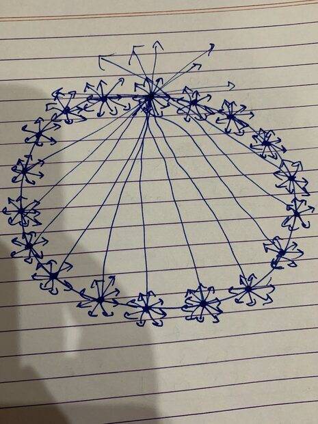

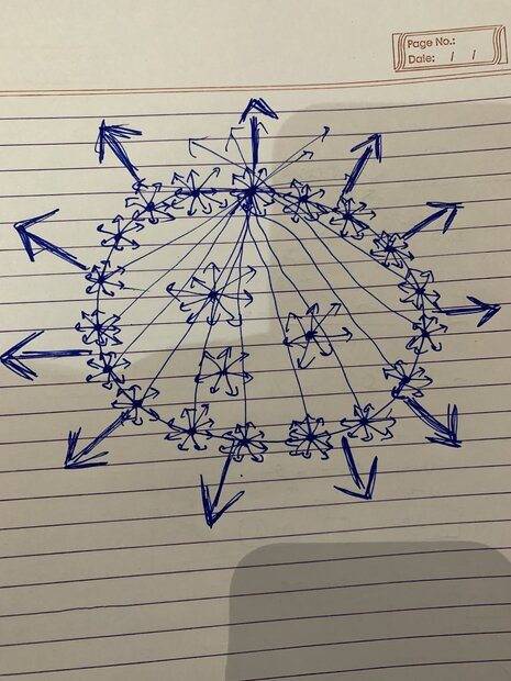

If there is a spherical conductor like this with excess charges on its surface then this is the field it sets up. Each e- would have there own radial field of lines. And all the e-s would exert a force on each charge and the net field on each charge and thus net force would be zero. All the e-s will be at rest. I tried to show this net effect of all field vectors on one top centre charge.
If I am correct then i want to ask what does it mean when we say the electric fields (vectors) are perpendicular to the surface of a charged conductor. Which field is this? Is this the net field vector at each point on the surface due to all the charges. Or is this field due to single e- that is perpendicular.

The net field is perpendicular to the surface and your drawing hints it is the case.
I have drawn fields due to all charges on one charge. The resultant of all is one field perpendicular to the surface. And in this way all resultant fields are perpendicular on the entire surface. Charges don’t move further due to this resultant because they are on boundary now.
We say net field on each charge is zero ?
There is only one field. In this case it's very easy to calculate. Due to symmetry the electrostatic potential is radially symmetric, i.e., it only depends on ##r=|\vec{x}|## (having the center of the sphere with radius ##a## at the origin of our coordinate system). Using spherical coordinates it fulfills the Laplace equation everywhere except on the spherical shell, where the charge sits. This means

I meant there are resultant field vectors all around the conductor due to all charges. One field around the conductor. These resultant field vectors all push the e-s at the boundary.
pardon me but I don’t understand the maths. I am a undergraduate.
@vanhees71 @Gordianus
Charges don’t move further due to these resultant vectors because they are on boundary now.
We say net field on each charge is zero.
What do you guys think ?

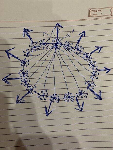

The big dark arrows are the resultant field vectors. This resultant field cannot push the e-s out. We say net field on each e- is zero.

I'm not sure whether your drawing is correct. Inside the sphere there shouldn't be any field lines, because there the electric field is 0.

The E field just outside the surface is always perpendicular to a tangent (line or plane) at that point on the surface. It is the net E field due to all the charges.
Each charge contributes its own field, just as though it was the only charge.
This is true inside the conductor as well as outside. The net field inside the metal is zero due to the joint E fields of all the charges on the surface. In reality there is a near-infinite number of E fields inside the sphere, all adding to net-zero E field.

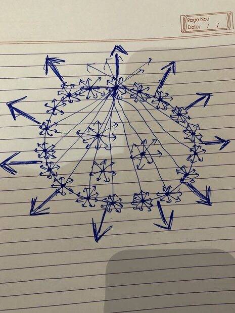

Net field inside at all points becomes zero due to all the surface charges because well the charges are all around. And the same charges produce a net field just outside the sphere which could be found out using gauss law.
@rude man something like this ? Inside the net field becomes zero at all points. I tried to show 3 points. All the charges on surface make zero internal field but outside the surface the same charges make perpendicular fields.
The resultant force of each charge can be zero, but the charge accumulated on the surface of the sphere is indeed being pushed by the radial electric field.
