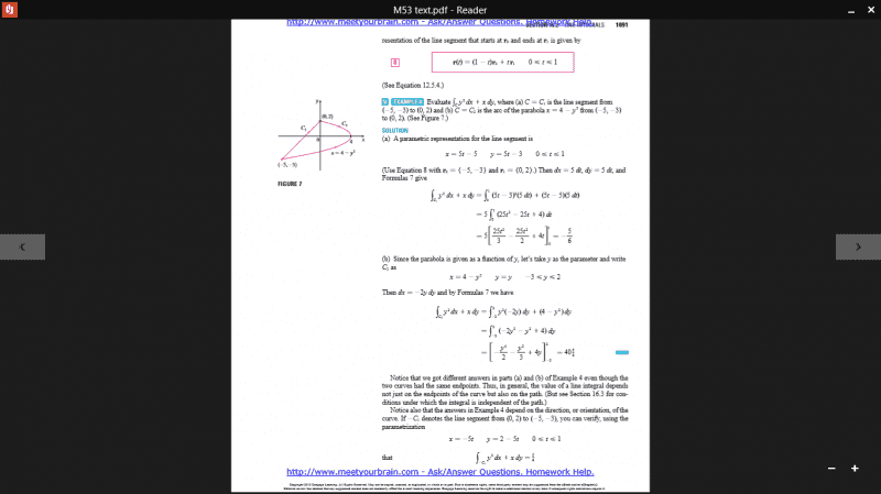

1) On page 1091, am I right to assume that example 4 could be solved using Green's Theorem?

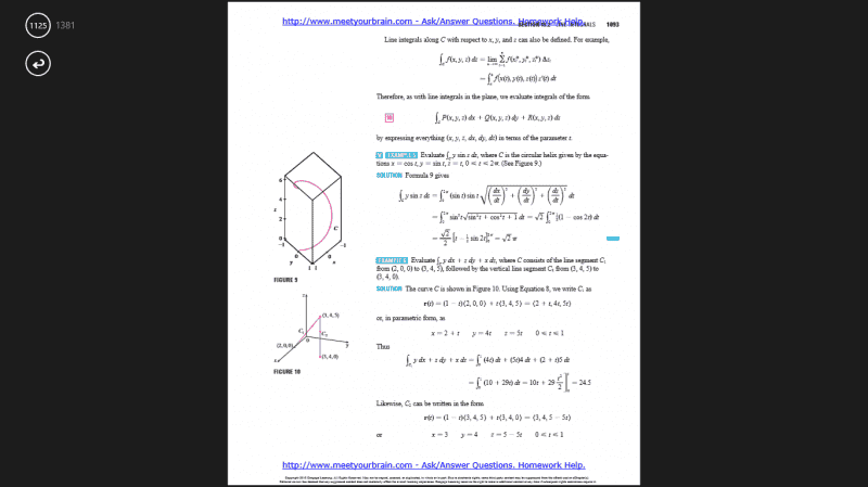

2) How about for example 6, on page 1093, or would we need a higher dimensional analog?

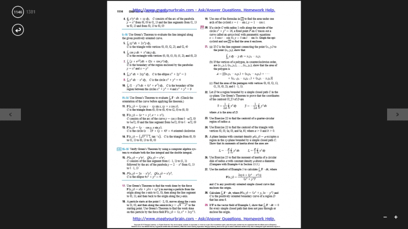

7) On page 1082, question 15 is conservative. Solving using the Fund Thm of Line Int gives 77. Using Green's theorem, the answer is zero. Why is there a difference?

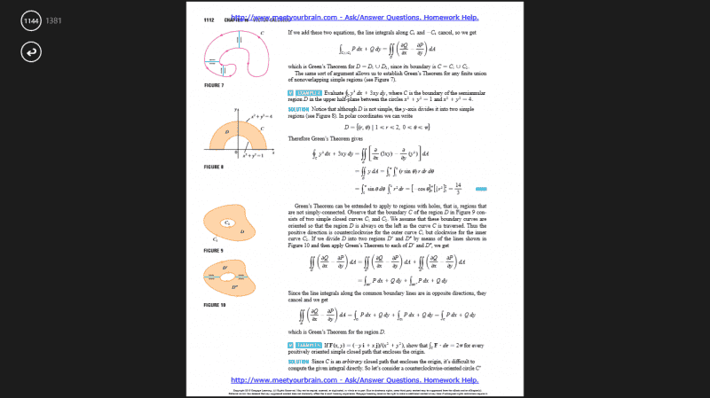

8) Why is example 4 of page 1112 "not simple" while exercise 10 of page ##1090## is?

1) As long as you follow the criterion of Green's theorem, it can be used. Sometimes it's just easier to evaluate the line integral directly though.
2) I'm almost certain I mentioned to you in a prior thread you can only apply Green's theorem in two-dimensions.

8) What is the definition of a simple region?
9) What is the definition of a closed region? What is the definition of a simple region? What is the definition of a conservative vector field?
