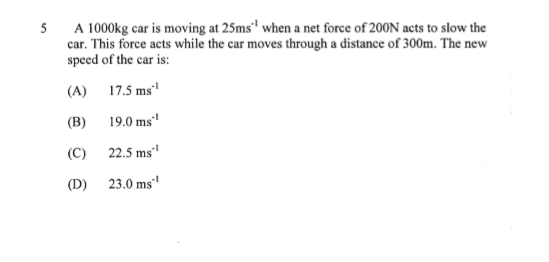

A 1000kg car is moving at 25ms when a net force of 200N acts to slow the car. This force acts while the car moves through a distance of 300m. Find the new speed.
Kinetic Energy equation
v2=u2+2as
Attempted the use of Kinetic Energy equation and v2=u2+2as
However the answer I get is 27.4 when the correct answer is 22.5

Yea see for yourself, its a multiple choice question. And I changed the original post so it makes some sense.

As the car slows down, the acceleration is negative. The force is opposite to velocity and displacement, so the work W is negative. You should have written W=Fd=-200*300= -60000 = 1/2mv2-1/2 m u2.
You changed the original post by changing the unit of speed from ms-1 to ms. Is it correct?
The answer is correct as ms-1
