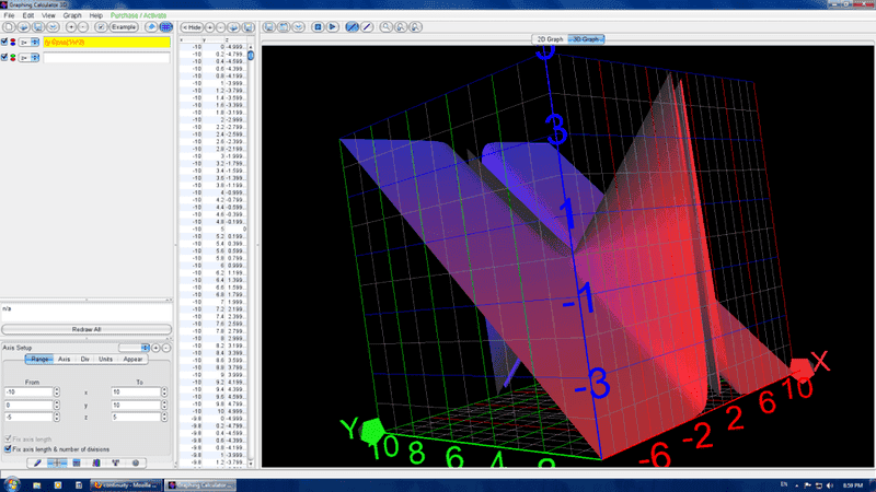

i am suppose to find all points that are continuous in the function f
f(x,y) = (y-5)cos(1/x2) if x not = 0
f(x,y) = 0 if x = 0
so from this picture
i see that for y = 5, every point of z=f(x,y) = 0.
but at points close to x, between -2 and 2, the graph is crazy, fluctuates like mad like you said :(
but it stills looks continuous at everywhere? i can't seem to find a place where there is a break
so far the conclusions are
when x=0, for any value y, the function =0
when x not = 0, for any value y except 5, the function is continous?
when x not = 0 , y = 5, the function = 0
so since x fluctuates like mad near 0 but the function f(0,y) = 0 , that means function is not continuous at x = 0 ? except at y =5 where every value of the function is 0. so continous?
btw, if i am in an exam, i can't use graphing cal, how am i suppose to know :(

Hi quietrain.
A few comments:
That graphing site is handy. WolframAlpha is also good for some graphing.
Your graph looks nice, but all of the "action" for cos(1/x2) occurs for -1 < x < 1. In fact all of the zeros of this function occur between -0.8and 0.8 . Here's a graph of cos(1/x2) by WolframAlpha. http://usera.ImageCave.com/DGSamSnyder/cos_rec_x_x.gif.jpg The seemingly solid blue region in the center is due to the fact that the oscillations of the function get closer together as |x|→0 . The oscillations are so close together that you will never see the discontinuity at x=0 as a break in the graph. See this link.
when x ≠ 0, for any value y except 5, the function is continuous?
Correct! the function 1/x2 is continuous everywhere except at x=0 . The cosine function is continuous everywhere, so the composition cos(1/x2) is continuous everywhere except at x=0.
so since x fluctuates like mad near 0 but the function f(0,y) = 0 , that means function is not continuous at x = 0 ? except at y =5 where every value of the function is 0. so continuous?
The first part is true.
The second part: ... well f(x,t) IS continuous at (x,y)=(0,0), but you need a more solid reason than that.
Example: g(x,y)=\left\{\begin{array}{cc}{{xy}\over{x^2+y^2}},&amp;\mbox{ if }<br /> (x,y)\neq (0,0)\\0, &amp; \mbox{ if } (x,y)=(0,0)\end{array}\right.<br />
If x=0, or if y=0, g(x,y)=0. However, this function is not continuous at the origin. Along the line y=x, g(x,y)=g(x,x)=(x2)/(2x2)=1/2, if x≠0. Similarly, along the line y=-x, g(x,-x)=-1/2, except at the origin.
http://usera.ImageCave.com/DGSamSnyder/xy_over_r_sqared.gif.jpg See this link.
I'll try to leave another post tonight with ideas for proving convergence & non-convergence.

oh so basically, it is continuous everywhere except at x = 0
and when y = 5, everywhere is 0 but i need to find the limit of f(x,y) as it tends to (0,5) and either show the limit exist (by squeeze theorem) or show limit doesn't exist by the trial error method you showed as an example?
so if i use squeeze thereom
|(y-5)(cos1/x2)| <or= |y-5|
so y-5 is the upper bound limit
so as function tends to (0,5)
|y-5| tends to 0
so f(x,y) as (x,y)tends to (0,5) = f(0,5) = 0 = limit
so i conclude that it is continuous at 0,5? but if x = 0 is non continous, then... ?
but what about (1,5)? (2,5)? (3,5) and so on for values of x? since they all make the function = 0 which is the limit, does it mean they are all continuous too?
PS: i don't seem to be able to see your graph :X

This is somewhat like the function:
G:= \left\{ \begin{array}{ll} x\cos\left( \frac{1}{x} \right) &amp; \mbox{, if } x \neq 0 \\ 0 &amp; \mbox{, if } x =0 \end{array} \right.
which is continuous at x = 0.
Again from WolframAlphahttp://usera.ImageCave.com/DGSamSnyder/x_cos_rec_x.gif.jpg
