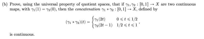

yes. the original problem says to do exactly as you say. I am sorry, i did not know that writing the problem differently would cause this issue!
  • Wow
So in this case, the domain you probably want to focus on is something that is a union of [0,1] and [1,2] with an equivalence relation where the two 1s are equal. You have to be pretty careful with notation here because the two 1s aren't equal in the original domain!

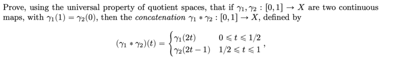

my professor taught us that disjoint unions can be thought of as ##U\times \{0\} \cup V\times \{1\}##. if U and V are both subsets of Y, and there is an equivalence relation on Y s. t. a u in U is similar to a v in V, then U and V belong in the same equivalence class?
I am trying to figure out how to use this to solve
it seems that the concatenation glues the two images of [0,1] under ##γ_1## and ##γ_2## together. but i am not sure how to establish that it is equivalent to a continuous map ##gp## so that ##g:X/\sim\rightarrow Y## and ##p:X\rightarrow X\sim##.
You shouldn't be thinking of gluing the images together, you should be thinking of gluing the domains together. The equivalence relationship is on the domain, not the image of the function.

You are starting with two functions defined on [itex][0,1][/itex] and you want to end up with another function defined on [itex][0,1][/itex]. That suggests taking two disjoint copies of [itex][0,1][/itex] (for example [itex][0,1] \times \{0,1\}[/itex]), and acting on each copy with a different function, giving you a function [itex]g : [0,1] \times \{0,1\} \to X[/itex]. You then use an euivalence relation to glue the endpoints of the copies of [itex][0,1][/itex] together in such a way as to get a function [itex]f[/itex] from the quotient space (which is homeomorphic to [itex][0,1][/itex]) to [itex]X[/itex]. Then [itex]g = f \circ p[/itex] and the universal property is used to show (by contradiction) that if [itex]g[/itex] is continuous then so is [itex]f[/itex].
