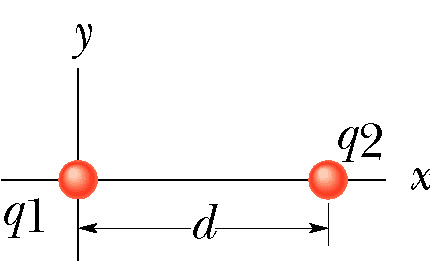

In the figure, two point charges q1 = 3.40×10-5 C and q2 = 1.70×10-4 C are separated by a distance d = 0.10 m. Compute their net electric field E (x) as a function of x for the following positive and negative values of x, taking E to be positive when the vector E points to the right and negative when E points to the left. Plot your values in your notebook.
What is E(-0.100)?
E(X)=k[(q1/x^2)-(q2/(d+x)^2)]
I used the above equation, but the answer was wrong. When E(-0.100), does that mean the x in the equation is also negative? I get the feeling I've messed up some of the signs.
There are two things wrong with you relevant equation.
  1. If you want the magnitude of the field due to a charge, you need the distance to that charge. That is correct for q1 in your equation, but not for q2
  2. The minus sign in your equation is only valid in 0 < x < d because there the field from q1 points to the right (positive x direction) and from q2 to the left.
When it says E(-0.100), does that mean the x value of -0.100, as in a point on the x-axis to the left of q1? (-0.100, 0)
For your first point, are you saying that it should be (d-x)^2?
Second point, that the two fractions should instead be added?
E(X)=k[(q1/x^2)+(q2/(d-x)^2)]
When it says E(-0.100), does that mean the x value of -0.100, as in a point on the x-axis to the left of q1? (-0.100, 0) -- Yes
For your first point, are you saying that it should be (d-x)^2? -- Yes. Better: (x-d)2
Second point, that the two fractions should instead be added? --- Yes/No:
To the right of a charge q/x2 points to the right
To the left of a charge q/x2 points to the left​
To get it in one expression, we often use this notation : ##\vec E(\vec r) = k\; q\; {\displaystyle \vec r\over |\vec r|^3}##
q itself also has a sign. In this exercise both q1 and q2 are positive. So
x< 0 both point to the left => add and put a minus sign in front
0<x<d q1 to the right, q2 to the left (as in your original relevant equation E(X)=k[(q1/x2) - (q2/(d-x)2)] )
d<x both point to the right => add (so indeed E(X)=k[(q1/x2) + (q2/(d-x)2)] )​
Make a drawing !
E(x<0)=-k[(q1/x^2) + (q2/(d-x)^2)]
E(0<x<d)=k[(q1/x^2) - (q2/(d-x)^2)]
E(d<x)=k[(q1/x^2) + (q2/(d-x)^2)]
These equations all worked! Thank you so much for explaining it all to me, I think I actually understand now why you would subtract vs. add!
