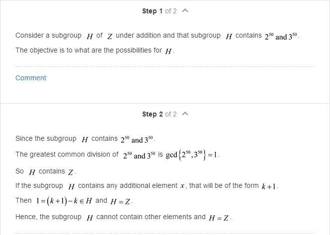

Suppose that H is a subgroup of Z under addition and that H contains 2^50 and 3^50. What are the possibilities for H?
Relevant concepts are just the definitions for a group and subgroup.
https://en.wikipedia.org/wiki/Group_(mathematics)
https://en.wikipedia.org/wiki/Subgroup
The solution I was given is the following:
But what I'm wondering about, and would appreciate an answer to, is the following:
But the subgroup has operation "addition" so 2^50 = 50*2 = (2*5*5)*2, and 3^50 = 50*3 = (2*5*5)*3, so the possibilities for H are:
H=Z, H=2Z, H=10Z, H=25Z, H=50Z.
Or am I missing something?
Firstly, after ##"H## contains ##\mathbb{Z}"## you can stop, because ##\mathbb{Z} \subseteq H \subseteq \mathbb{Z}## (the latter for being a subgroup) already implies ##H = \mathbb{Z}##.
What you are missing is, that ##2^{50} \neq 50^2## or ##100##.
Thanks for reply. But if we write out the notation, then, for group with operation "addition":
250 = 50*2, and 502=2*50, and Z is commutative? That is, in general, an=n*a
No, you can't confuse these notations. ##2^{50}## is simply a number and the subgroup is ##(H,+)=2^{50}\cdot (\mathbb{Z},+) + 3^{50}\cdot (\mathbb{Z},+)##. Otherwise one would have defined ##H=100\mathbb{Z}+150\mathbb{Z}=50\mathbb{Z}##.
