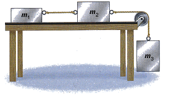

There are three blocks connected by strings as shown in the figure. Each block has the mass as following mass,
m1=0.8kg
m2=2.2kg
m3=1.7kg
Assuming there is no friction,
F=MA
In my FBD of the hanging box
[itex]\uparrow[/itex] <--- Tension
[itex]\downarrow[/itex] <--- W=mg
^^ in y direction: T-W=0
T=W
The FBD of the box on the table
[itex]\uparrow[/itex] <---Normal Force
[] [itex]\rightarrow[/itex] <--- Tension
^^ x direction: t=0
y direction: Fn-W=O
But I am completely confused on how to find the tension of the boxes

Call the tensions "T1" and "T2", and the acceleration "a" (it'll be the same for all three boxes, won't it? :wink:)
Then do F = ma three times, once for each box, and solve …
what do you get? :smile:
But if i do that the acceleration = 0 and so it makes all the forces 0... right??or am i missing something and it should be gravity?
Yes, you need to include W (=mg) for the hanging box.
W for the hanging box is 16.66
and W for box 2(m2) is 21.56...
Where do i go from there, because that doesn't give me acceleration...
i figured it out... i ended up having to do m2a+m1a
