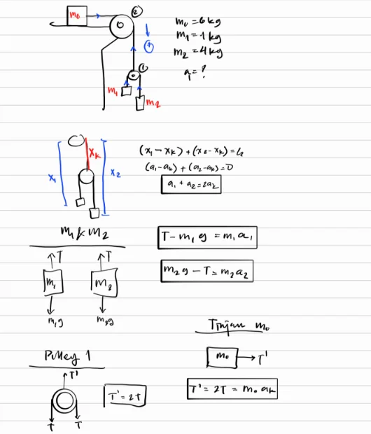

michelp
Three objects m0, m1, m2
The files are attached
I hope the sketch is good enough

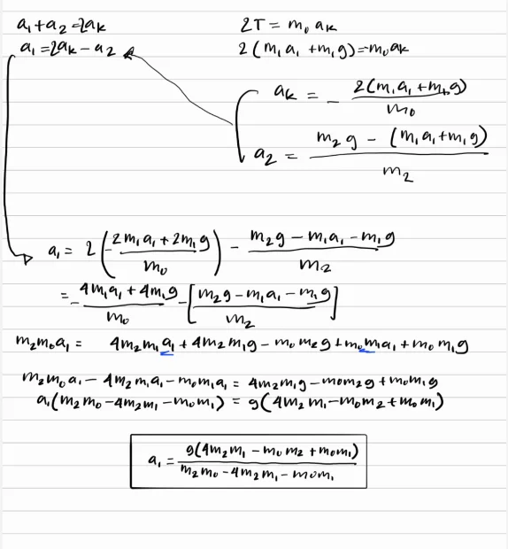

My attempt:
anything with k means it's the pulley's. ak means the pulley's acceleration, xk means the pulley's rope length.
So my idea here was to use the constraint a1 = 2ak - a2, find the eq for ak and a2 in terms of a1, group them and find a1, but instead I got that a1 = -9.8 which I don't think is the correct answer. Please help me, it'd be nice to point out where I got it wrong. I am also new to this website
I had to zoom way in to read the handwriting.
Your first assertion is that ##a_1 + a_2 = 2a_k##. This is obviously correct. The acceleration of the upper block is the average of the accelerations of the lower two blocks.
Your next two assertions looked strange to me. You have ##T - m_1g = m_1a_1## and ##m_2g - T = m_2a_2##. It seems that you have adopted a sign convention where ##a_1## is positive upward and ##a_2## is positive downward.
But this means that your earlier assertion is now incorrect. It depended on a sign convention where ##a_1## and ##a_2## were both positive downward.

I suppose the problem statement says no friction between surface and ##m_0## ?
How can you write ## \ T-m_1g=m_1a_1 \ ## and ##\ m_2g - T = m_2a_2 \ ## without getting confused with the directions of these ##a_i## ? the picture suggests ## \ T - m_2g= m_2a_2 \ ## if up is positive !
[edit]: ah ! JB was faster -- fortunately we agree !
Did you notice that your expression cannot possibly be correct because its numerator is the negative of the denominator and simplifies to ##a_1=-g##? This is free fall!
Note that mass ##m_0## doesn't "know" (or care) whether there is a mass or an Atwood machine at the other end of the string. It will accelerate just the same. So the pulley of an Atwood machine can be replaced by an equivalent hanging mass, a step which greatly simplifies such problems. To find out how this is done, read this article.
In this case, replacing the Atwood machine with an equivalent mass allows you to find the acceleration of the Atwood pulley ##a_0##. Then all you have to do is find the acceleration of the masses in an Atwood machine hanging from the ceiling of an elevator that accelerates down with acceleration ##a_0##.

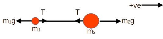

@michelp, this is a bit late in the day, but it might explain the misunderstanding...
michelp said:
... I did the early steps with my teacherand thats what he wrote. I assume that's incorrect?
In the case of a simple Atwood machine (with ##m_2 > m_1## say), it is not uncommon to find equations written in the form:
## T – m_1 g = m_1 a## and
##m_2 g – T = m_2 a##
For example: https://en.wikipedia.org/wiki/Atwood_machine.
I’d guess this is how your teacher taught it.
In effect, ##T, a## and ##g## are magnitudes and directional signs are allocated ‘manually’. This is equivalent to treating the system as ‘straightened-out’ with the positive direction to be the direction of the larger mass’s acceleration:
This works because the pulley's only function is to change the direction of the tension. For more complicated systems this approach is unsuitable, as noted in previous posts.

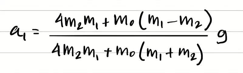

Turns out the problem really was the sign of convention being inconsistent. I hope I got it right this time. I'm still a little confused with the LaTeX so I'll be using my handwriting for now.
michelp said:
View attachment 369247Turns out the problem really was the sign of convention being inconsistent. I hope I got it right this time. I'm still a little confused with the LaTeX so I'll be using my handwriting for now.
In line ##\LaTeX##:: ##a_1 = \frac{4 m_2 m_1 + m_0 ( m_1 - m_2 )} {4 m_2 m_1 + m_0 (m_1 + m_2)} g##
Which should render as ##a_1 = \frac{4 m_2 m_1 + m_0 ( m_1 - m_2 )} {4 m_2 m_1 + m_0 (m_1 + m_2)} g##
I tossed in some white space in the unrendered LaTeX for what I think is better readability of the code. Rendering removes that. If you wanted white space in the rendered version, you would use a backslash escape for the spaces: "\ "
To put it in a separate line: \$$a_1 = \frac{4 m_2 m_1 + m_0 ( m_1 - m_2 )} {4 m_2 m_1 + m_0 (m_1 + m_2)} g\$$
Which should render as $$a_1 = \frac{4 m_2 m_1 + m_0 ( m_1 - m_2 )} {4 m_2 m_1 + m_0 (m_1 + m_2)} g$$
In order to display back to back pound signs and dollar signs and not render the LaTeX I had to use some different trickery.
michelp said:
I get the same equation as you - but don’t forget that you haven’t completely answered the question. You are given values for the masses, so you will need to calculate a value for ##a_1##’s magnitude and state its direction.
