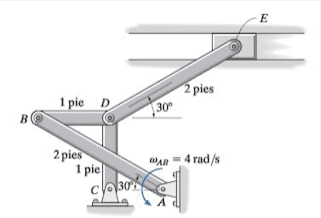

If the angular velocity of link AB is w(AB)=4 rad/s at the instant shown, determine the velocity of the sliding block E at that instant. Also, identify the type of motion of each of the four links.
V = w(r)
Four-bar linkage diagram with pinned points B, C, A and D, slider E, link lengths 1 pie, 2 pies and 2 pies, angle 30° and angular velocity ω_AB = 4 rad/s at A.
Hi! everyone! ;)
I have a problem with the development of this problem.
I need to resolve it with 2 procedures: trigonometry and instant centers. My advance can be see in the next image:

The instant centers procediment its (1) up and trigonometry procediment its (2) down.
I know that the result its 4 rads/s. But in my answer its not make the sense ;( and i don't know why the angular velocity of "D" its 4 rads/s.
PD: I don't can use cross product for resolve it... only trigonometry and instant centers (separately).
Thanks for read ;)

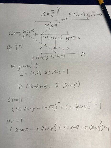

I would introduce xy coordinate as sketched.
From these linear equations for sin##\phi## and cos##\phi## we can delete ##\phi## and get x, the horizontal coordinate of E, as function of ##\theta## which is function of time.
[EDIT] The formula are written as
[tex](x/2-\cos\phi-\beta)^2+(1-\sin\phi)^2=1/4[/tex]
[tex](x/2-\cos\phi-\cos\theta)^2+(1-\sin\phi-\sin \theta)^2=1/4[/tex]

  • Handwritten geometry sketch of a linkage with x and y axes, points E, D, B, C and A, angles phi and theta, and the equation setup for E = (x(t), 2) with CD = 1 and BD = 1.
yep, i can use a free body diagram, but in this pariticulary case i only can use the procedure as I put it. The most important are the traslation and rotation diagram and the use of angles in triangles.

Cool, so the steps I would think about when going down the velocity diagram route are:
1. A and C are fixed
2. E is constrained to pure horizontal movement, as is D (in this case) as CD is vertical
3. We know ##\omega_{AB}## and thus know where point B is
4. To get from point B to point D, we then know there must be a rotation between the two
5. Then to get from D to E, given that E is constrained to horizontal movement, it suggests to me that ##\omega_{DE} = 0## at this instant. However, you said that the answer is ##\omega_{DE} = 4 ## rad/s, or did I misunderstand what you said?
I hope this rough outline makes sense. I can try to make a sketch a bit later

This very helpful!, i know that my mistakes its in the diagram and their angles. wDE= 4 rad/s based on assumptions,
Consider that:
1) E can only have horizontal movement.
2) Only the horizontal component of the instantaneous velocity of D has influence on E.
3) Because both are connected by a horizontal link, the horizontal components of the instantaneous velocity of D and B must be equal.
4) Since you are given the angular velocity of the 2 feet long link AB, you can calculate the tangential velocity of B and then, its instantaneous horizontal component.
