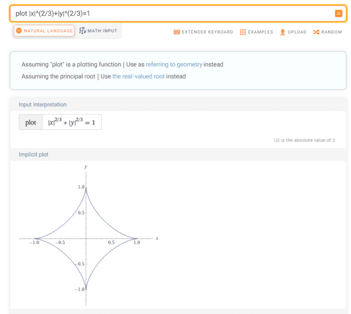

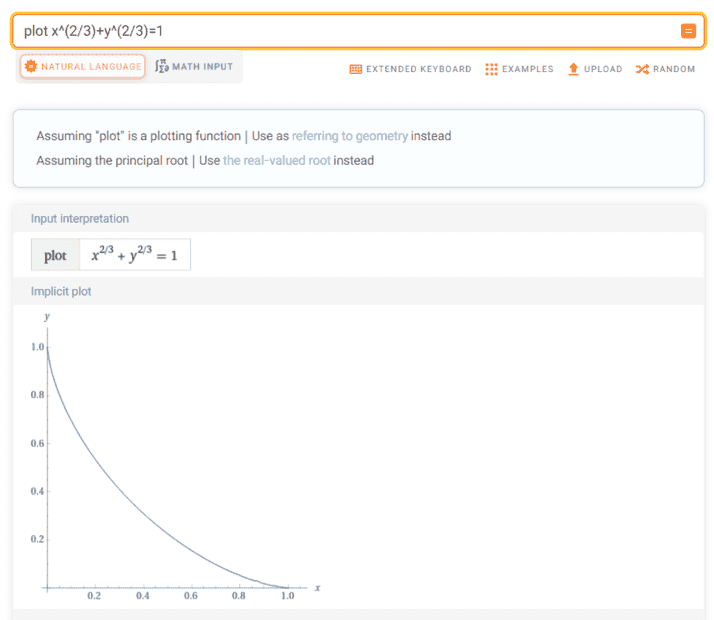

You should consider negative x y case.
I seem not to get you. Consider negative cases in what way?
I interpreted the equation as well as Wolfram do as below shown.
As for your
[tex]\sqrt[3] x=\cos t ,\sqrt[3] y=\sin t[/tex]
I am not sure whether [tex]\sqrt[3]{-1}=-1[/tex] is a conventional expression. Say it is so,
[tex](-1)^{2/6}=1^{1/6}=1 \neq (-1)^{1/3}[/tex]
That seems inconvenient.

I don't believe there is any problem with ##\sqrt[3]{-1} = (-1)^{1/3}##, both of which are equal to -1.
However, when you start manipulating the exponent, using the properties of fractional exponents, then I agree that you run into trouble when the base is negative.
Having thought about things a bit longer, @anuttarasammyak, I agree with what you are saying. The parametric equations ##x = \cos^3(t)## and ##y = \sin^3(t)## agree with the resulting equation that @chwala got: ##x^{2/3} + y^{2/3} = 1## only when both x and y are positive. For negative values of x or y, which map to values of t in the parametric equations, you run into problems of inconsistency in the non-parametric equation.
