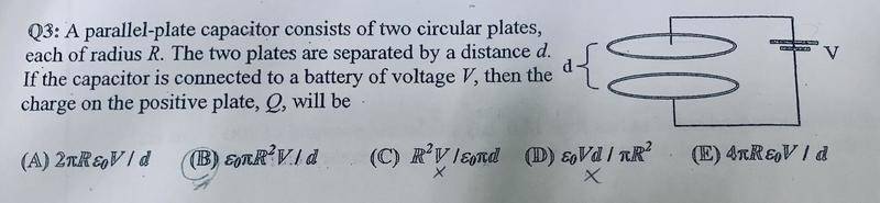

Find the charge on the positive circular plate

Multiple-choice question Q3 on a parallel-plate capacitor of plate radius R and separation d, connected to a battery of voltage V, with options A through E for the charge Q, plus a schematic of the two circular plates and battery.
Q = C ΔV
C = ##\frac{ε A}{d}##
A = π R2
Q = (π R2*ε V)/d
Is my answer correct ?

Looks good to me.
