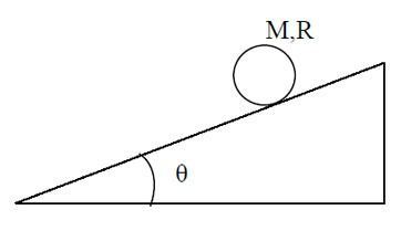

It's a cilinder of mass M and radius R rolling without slipping and I'm asked to find the maximum value of the static friction coefficient for the cilinder to roll without slipping.
Non-slip conditions:
[tex]\displaystyle v=\omega R[/tex]
[tex]\displaystyle a=\alpha R[/tex]
Torque:
[tex]\displaystyle \tau =I\alpha[/tex]
Net force in axis X (my axis is along with the inclined plane):
[tex]\displaystyle -mg\sin \theta -{{\mu }_{s}}N=ma[/tex]
Equation in axis y will give me the normal force:
[tex]\displaystyle N=mg\cos \theta[/tex]
So:
[tex]\displaystyle -mg\sin \theta -{{\mu }_{s}}mg\cos \theta =ma[/tex]
Solving for u:
[tex]\displaystyle {{\mu }_{s}}=\frac{-g\sin \theta -a}{g\cos \theta }=\frac{-g\sin \theta -\alpha R}{g\cos \theta }[/tex]
So I need to find out the angular aceleration:
[tex]\displaystyle -{{\mu }_{s}}mg\cos \theta \cdot R=\frac{1}{2}m{{R}^{2}}\cdot \alpha[/tex]
[tex]\displaystyle \alpha =\frac{-2g{{\mu }_{s}}\cos \theta }{R}[/tex]
Replacing alpha in the equation I get that:
[tex]\displaystyle {{\mu }_{s}}\le \tan \theta[/tex]
But the option marked as correct is:
[tex]\displaystyle {{\mu }_{s}}\ge \frac{\tan \theta }{3}[/tex]
any help?
Thanks!

Check your I
What's wrong out the inertia of the cilinder? Isn't it 1/2*MR^2? Thank you!
Hello Hernaner28,
You have implicitly assumed the limiting friction case in your rolling situation (fixing fs=μN )
First of all treat friction as an unknown independent of the normal reaction of the cylinder on the inclined plane to get an expression for friction in terms of Mass of object,the inclination of the plane ,The radius and the Moment of inertia.Now the maximum friction that your incline can offer at the given N is ____________?(answer) So your calculated friction must not exceed _________?
Try to answer them and using the expression that comes as an interpretation calculate the condition again.I pretty much think this gives the actual answer as marked.Does this help?
regards
Yukoel
But what was wrong about what I did? I worked with the limiting friction case because that would be the maximum coefficient of friction... that's why I finally get it has to be "less or equal".

Hernaner28 said:
Less or equal to tan(theta) as I finnaly worked out. I understand your thinking but I don't understand what is the difference between mine and yours, and what's the mistake about mine..
Thanks
Hello
I think you have by mistake yielded your derivations to a≥Rα.Contradictory to pure rolling isn't it?(The last step quoted)
regards
Yukoel
Ah yes, you're right. So what is what I got? Because it is not incorrect but maybe it is not what I was asked

Ah yes you're right :D ! THANKS! Anyway, let's assume the last result is fine, then, what's the meaning of what I got? Is it the maximum coefficient of friction for the cilinder not to slip?
I don't know why but now I get the correct answer... even with my first thinking (nothing was wrong about it). I think it was because of the direction of the force which azizlwl corrected.
THANKS!
I get:
[tex]\displaystyle F=\frac{mg\sin \theta }{3}[/tex]
The friction F force is:
[tex]\displaystyle {{\mu }_{s}}mg\cos \theta =\frac{mg\sin \theta }{3}[/tex]
[tex]\displaystyle {{\mu }_{s}}=\frac{\tan \theta }{3}[/tex]
For the limit case... so that would be the minimum value, or maximum?
The exact answer is μ≥ (2/7)tanθ
The maximum ratio friction/N is μs.

Yukoel, I got the correct answer now:
But that is a equality, not inequality, now I have to decide the sign of the inequality. That value is the minimum or maximum value for the cilinder not to slip?
Hello azizlwl
I think you have mistaken cylinder as a sphere (I=(2/5)M*(r^2)
However for cylinders (I=(1/2)M(r^2) )
I am pretty much sure that the answer sought as third of the value of tan(θ) is correct for the cylinder. And (5/2) times your answer your answer is correct for the sphere.
You had begun with the limiting case right? You had to have a limiting answer .Now think static friction had to atleast have this value of friction you derived .A little bit non mathematically this should be the least value.
Now calculate off the general value of friction for a body with a given I,M,θ(for incline)and R will you? This value of friction gives a general formula for f,and a(acceleration).You can use this for future reference too.
regards
Yukoel
Alright then that's correct! Calculating for the general case I get that the friction force (not mu) should be:
[tex]\displaystyle F=\frac{IMg\sin \theta}{{{R}^{2}}+I}[/tex]

Alright but that general value of F indicates the unique value for an unique situation (given all that parameters) but that value has a upper bound which would be the maximum it may have not to slip (I am getting it! :)) so, if I make it less than or equal to umgcos(theta) I am actually bounding the result to find the minimun coefficient, right?THANKSS!
Hello Harnaner28
Not exactly to say .Your value for f works good for any given body with a given I ,M and R.Though to say it indicates rolling as a precondition.
Yes this is true.
Yes indeed .But it was not intended ,you bounded the friction force but mathematical rules yielded µ on the right side ,just to say.
