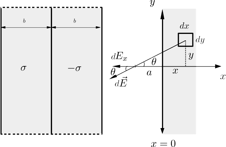

> Q:The two charged strips in the following picture have width [itex]b[/itex], infinite height,and negligible thickness(in the direction perpendicular to the page).Their densities per unit area are [itex]\pm \sigma[/itex] .​
>a)Find the field magnitude produced due to one of the strips from a distance [itex]a[/itex] away from it(in the plane of the page).​
>b)Show that the force(per unit height) between the two strips is equal to [itex]\frac{\sigma^2 b \ln(2)}{\pi \epsilon_0}[/itex]. Note that this result is finite, even tough the field in the boundary of the strip diverges.​

As the figure shows I calculate the Field from a distance [itex]a[/itex] from the first tape:
$$\begin{aligned}E_x&=\int\int \frac{k dq}{r^2}\cos{\theta} \\ &=k\int\int \frac{\sigma da}{r^2}\cos{\theta} \end{aligned}$$
From the geometry of the figure we get:
$$\begin{aligned}E_x&=k\sigma\int_{-\infty}^{\infty}\int_0^b \frac{ dx dy}{(a+x)^2+y^2}\cdot\frac{a+x}{\sqrt{(a+x)^2+y^2}} \\ &=k\sigma\int_{-\infty}^{\infty}\Big(\int_0^b \frac{ (a+x)dx }{\Big((a+x)^2+y^2\Big)^{3/2}}\Big)dy\end{aligned}$$If [itex]u= (a+x)^2+y^2=(a^2+2ax+x^2+y^2)[/itex], thus [itex]du=(2a+2x)dx \Rightarrow du/2=(a+x)dx[/itex]
$$\begin{aligned}E_x&=k\sigma\int_{-\infty}^{\infty}\Big( \int_{c'}^{d'} \frac{du}{2u^{3/2}} \Big)dy=\frac{k\sigma}{2}\int_{-\infty}^{\infty}\Big( \Big[ \frac{-2}{u^{1/2}}\Big]_{c'}^{d'} \Big)dy \\ &=-k\sigma \int_{-\infty}^{\infty}\Big( \Big[(a+x)^2+y^2)^{-1/2} \Big]_{0}^{b} \Big)dy \\ &=-k\sigma \int_{-\infty}^{\infty}\Big( (a+b)^2+y^2)^{-1/2} -(a^2+y^2)^{-1/2} \Big)dy \\ &=-k\sigma \int_{-\infty}^{\infty}\Big( \frac{1}{\sqrt{(a+b)^2+y^2}} - \frac{1}{\sqrt{a^2+y^2}} \Big)dy \end{aligned} $$

$$E_{\sigma}=-k\sigma \ln \Big(\frac{(a+b)^2}{a^2}\Big)$$
This result seems right because the field diverges in [itex]0[/itex] and in [itex]-b[/itex] .
Using a similar approach we can calculate the other plate field changing the limits of integration of [itex]x[/itex] from [itex]b[/itex] to [itex]2b[/itex]

There is no need to sum fields. The force on the left strip comes from the right force only (forces from the left strip on the left strip cancel due to symmetry).
That just leaves an integral over the electric field strength multiplied by the charge density, within the borders of the strip. That integral looks easy to evaluate.
