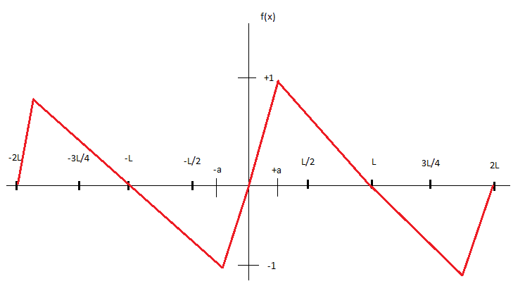

Sketch the function:
[itex]f(x) = \begin{Bmatrix} \frac{-x}{a} & 0 \leq x \leq a \\ \frac{x-L}{L-a} & a \leq x \leq L[/itex]
where f(x) is an odd function and is periodic in 2L.
And a is a constant less than L/2
Find the Fourier series for the function f(x).
I have attached a rough sketch of the function, its not perfect but good enough to get the general idea. We can see that the function is odd and Discontinuous at f(a) and f(a+L)

so.. do i then split this up into 2 separate integrals:
[itex]b_n = \frac{1}{L}\left[ \int_0^a \left(\frac{-x}{a}\right) sin(\frac{n\pi x}{L}) dx + \int_a^L \left(\frac{x-L}{L-a}\right) sin(\frac{n\pi x}{L})\right][/itex]
am i able to do this?
the thing that is confusing me the most is wether i am using the right values for L (ie, not sure wether its supposed to be 1/L , 2/L , 1/2L etc)
I followed this through and ended up with a horrible expression containing terms in:
[itex]sin\left(\frac{n \pi a}{L}\right)[/itex]
and
[itex]cos\left(\frac{n \pi a}{L}\right)[/itex]
thanks

Looks good so far.
The period T is 2L, so the angular frequency is ω = 2π/T = 2π/2L = π/L. The argument of the sines and cosines is nωx, which is equal to what you have.
I've worked the integrals through and ended up with the solution:
[itex]f(x) = \sum_{n=1}^{\infty} \frac{-2L^2}{an^2 \pi^2 (L-a)} sin\left(\frac{n \pi a}{L}\right) sin\left(\frac{n \pi x}{L}\right)[/itex]

Looks good. Here's a plot of your series using the first ten terms with L=1 and a=0.2.
