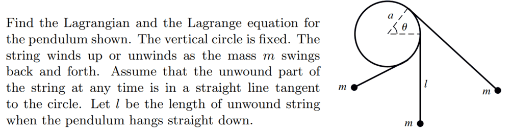

Find the Lagrangian of an unwinding pendulum

See image
L=T-V, ke=1/2mv^2

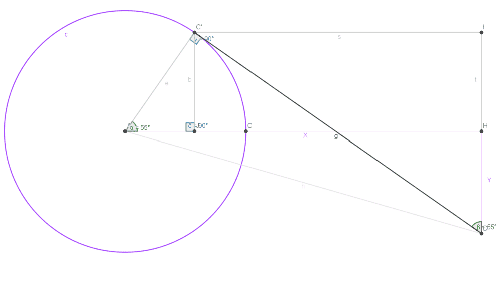

I think my confusion on this is where the best origin for polar coordinates is. I've tried the center of the circle, and note the triangle made from the r coordinate reaching out to ##m, a,## and ##l+a\theta##. Then
$$r=\sqrt{a^2+(l+a\theta)^2}$$
$$\dot r = \frac {a(l+a\theta)} {\sqrt{a^2+(l+a\theta)^2}}$$
but my book has a much simpler expression for T where ##\dot r = 0##...I am missing some crucial insight.

You should not be using polar coordinates. All you need to know is the kinetic and potential energies of the system expressed in terms of ##\theta## and its time derivative. You can do this by writing down the position of the bead as a function of ##\theta## in Cartesian coordinates and differentiating it to find the velocity.

From that I was able to get
$$x=(l+a\theta) sin\theta + a cos\theta$$
$$y=-(l+a\theta) cos\theta + a sin\theta$$
and so the ##(\dot x^2 + \dot y^2)## term in the kinetic energy was just ##(l+a\theta)^2\dot \theta^2##!
Thanks so much.
