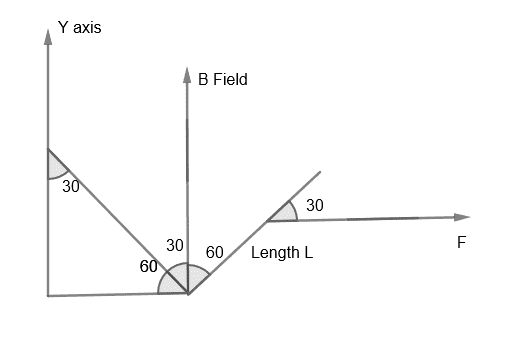

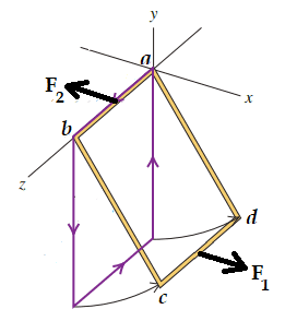

The rectangular loop of wire shown in Fig.has a mass of 0.15 g per centimeter of length and is pivoted about side ab on a friction less axis. The current in the wire is 8.2 A in the direction shown.Find the magnitude and direction of the magnetic field parallel to the y-axis that will cause the loop to swing up until its plane makes an angle of 30Deg with the yz-plane.
F = IlBsin(Θ); F = mg
i tried to draw the directions of the parameters
The direction of B is clear since then the Force will be in the positive X direction. I am bit confused with the direction of Force, how would i draw it and the components. Is the gravitational force i have drawn is correct? Do we have better tools to draw these diagrams in 3D which will make life easy. Can i neglect the Force on ab? Please advise.
What conditions must be satisfied in order for the loop to be in static equilibrium?
It looks like you have the correct directions for the magnetic forces on the top and bottom segments of the loop. Are there magnetic forces on the other two segments? I'm not sure what your notation "0 F" indicates in the drawing.
Your force of gravity has the correct direction. At what point should this force be considered to act?
Your direction for ##\vec B## also looks correct.

The 0F indicates 0 force acting on the side segments when they are in the initial position, since the B field is parallel and antiparallel to the side segements. But when they have moved to 30 Deg, there is a force acting on the side segments as well.

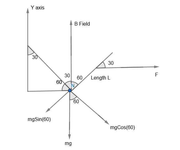

The diagram showing the direction of force on the lower segment. Is it correct?
I consider this applying on the lower segment. Is it correct? I am mixing everything, very confused. Please advise.

I'm having a little trouble interpreting your last figure. In your first post, I think you have the correct directions for the forces on the top and bottom segments of the rectangle:
The force, ##F_1## on the lower segment ##cd## is parallel to the x-axis and points towards positive x.
The force, ##F_2## on the upper segment ##ab## is parallel to the x-axis and points towards negative x.
Similarly, can you describe the directions of the forces on sides ##bc## and ##ad##?
It looks like you are drawing the gravitational force ##mg## as acting on the lower segment ##cd##. But, ##mg## acts at the average location of all of the mass. That is, it acts at the center-of-mass of the loop. This is important if you are going to calculate torques.
The side ##ab## is mounted on the z-axis so that the loop can rotate about the z-axis. The z-axis will provide a supporting force ##\mathbf R## acting on the side ##ab##. Without this force, the whole loop would fall. However, if you take the z-axis to be your axis for calculating torques, you will not need to worry about this force since ##\mathbf R## produces zero torque about the z-axis.
Yes i messed up everything in the 2nd post, now i think i got it back again. For the side segments i can directly say
bc -> +Z direction
ad -> -Z direction

It means the total mass of rectangular loop is ##2*(8+6)*0.15 = 4.2 g##. Other thing is I found that the gravitational force having a component in the X direction and Force F1 acting along the same X direction, there is one more component of gravitational force acting in the +Z direction. I do not see any component of force acting in the negative X direction. Then how it will balance? My other question Do I need to equate the Forces or torques? What is the difference? Please advise.
The gravitational force acts vertically downwards, as you indicated in your first post. So, there is no x or z component of the force of gravity.
To see how the forces can add to zero, you must include all of the forces. There is a magnetic force on each of the four sides of the loop. There is the gravitational force. And then there is the force of support at the mounting along the z-axis.
