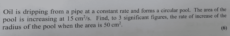

see attached.
rate of change
My approach is as follows;
##\dfrac{dr}{dt}=\dfrac{dr}{da}⋅\dfrac{da}{dt}##
##\dfrac{dr}{da}=\dfrac{1}{2πr}##
##\dfrac{dr}{dt}=\dfrac{1}{2πr}⋅15##
##\dfrac{dr}{dt}=\dfrac{7.5}{πr}##
and noting that ##r= \sqrt{\dfrac {50}{π}}##
##\dfrac{dr}{dt}=\dfrac{7.5}{12.533}=0.598## cm/s
*kindly note that i do not have the solutions ..

I mean, use units throughout your calculation. Do not just slap them on at the end and assume that they are correct. For example, this
should read
\frac{dr}{dt} = \frac{1}{2\pi r} (15\ {\rm cm}^2/{\rm s})

@Delta2 I had not included the units initially...I just amended. That's why this comment is valid.
@Orodruin I think the units at the end should be good enough...I don't think it's a standard math practise for students to show or rather indicate units at each and every step of their working.
ok ok, but still think @Orodruin is a bit sort of pedantic but yeah if we want to be absolutely correct...

Answering with a number when the question asks for a dimensionful quantity is just not correct. Sure, you may assume that units match up but if 18 years of teaching has taught me anything, it is that you cannot assume that students get their units right. Therefore, I think it is good practice to be pedantic about following units throughout any computation. The next one may not be as obvious.
